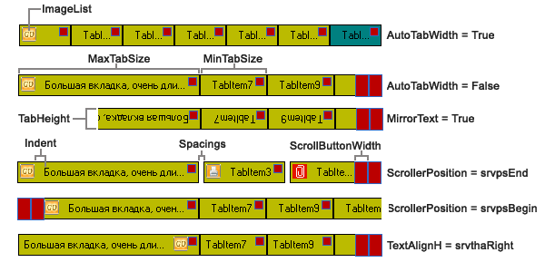

The following properties affect the size of tabs: AutoWidth, MinTabSize, MaxTabSize, TabHeight.
The following properties affect the layout of each tab: Indent, Margins, MirrorText, TextAlignH, TextAlignV.

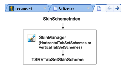

TSRVTabSet is a skinnable component. Skins are used when SkinManager and SkinSchemeIndex properties are assigned. You can draw various parts of the control yourself using custom drawing events.
SRVTabSet SkinScheme
