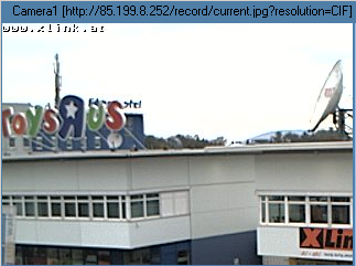

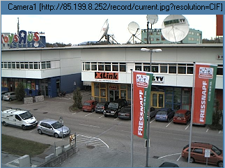

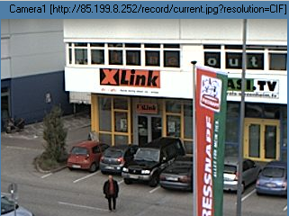

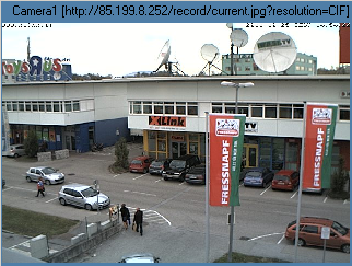

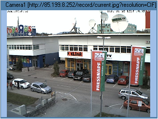

View Mode  |
Sample  |
vvmNormal A video is displayed at the top left corner of the window, without stretching  |
vvmCenter A video is displayed in the center of the window, without stretching  |
vvmCut A video is stretched proportionally so that the smallest side fits the window, the largest side is truncated
vvmAspect (default) A video is stretched proportionally to fit the window, keeping the side proportions.
vvmStretch A video is stretched to fit the window.  |
