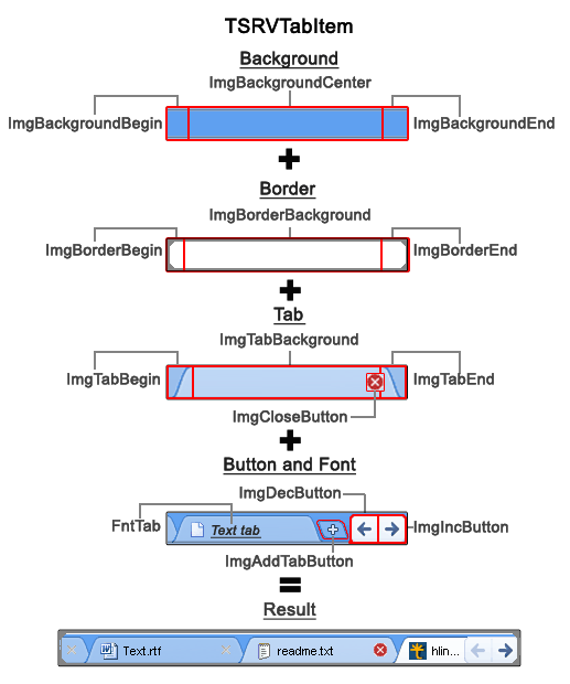

FntTab: Integer specifies the index in the TSRVSkinManager.Skins[i].Fonts collection. It defines the font for text in the tab. If you use a vertical tab, this font must be a TrueType/OpenType. The default value is -1.
Other properties define indices in TSRVSkinManager.Skins[i].Elements collection. All these properties are Integers, their default value is -1.
Buttons on the tab set:
•ImgDecButton for the button to scroll to the beginning;
•ImgIncButton for the button to scroll to the end;
•ImgAddTabButton for the button for adding a new tab.
Tab:
•ImgTabBegin for the left/top side of tab;
•ImgTabEnd for the right/bottom side of tab;
•ImgTabBackground for the tab background;
•ImgCloseButton for a button for closing the tab.
Border (the border is drawn above all other parts):
•ImgBorderBegin for the left/top side of the control border;
•ImgBorderEnd for the right/bottom side of the control border;
•ImgBorderBackground for the middle part of the control border (since the border is drawn after all other content, this image must have a transparent area in the middle).
Background:
•ImgBackgroundBegin for the left/top side of the control background;
•ImgBackgroundEnd for the right/bottom side of the control background;
•ImgBackgroundCenter for the middle part of the control background.
