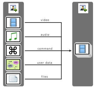

This topic explains how data (video, audio, files, commands, etc.) may be transferred between two applications via the network.
One application (which sends data) uses TRVCamSender component. Another application (which receives data) uses TRVCamReceiver component.

The receiver establishes a permanent connection to the Sender (or the MediaServer). For each data type, a channel is created. All channels make up a session. When all channels are opened, a session is created. If at least one channel is closed, a session is terminated.
In this mode, all the Receiver's events are used: OnConnecting, OnConnected, OnDisconnect, OnConnectError, OnOpenChannel, OnCloseChannel, OnSessionConnected, OnSessionDisconnected. In all events, except for OnSessionConnected, OnSessionDisconnected, the parameter SessionKey=0.
