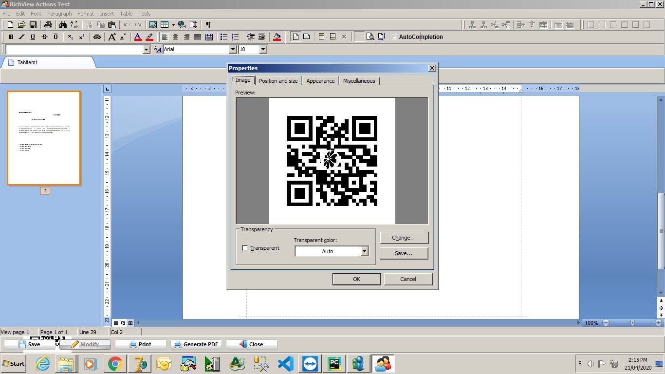

HI,

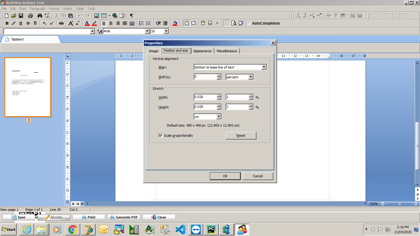

I am generating a Qrcode via an API, which returns the Qrcode as a BMP file. This file a insert into a Scalerichview as per the function given below. After inserting, the this image is seen as a dot. I am able to click this image and change the properties. After that is image is show correctly. I am using this in an editor. Ataching the properties image for reference. I understand this has something to do with the style may be.

Obviously, it happens because not pixels, but twips or EMU are used as measure units, so 30 is a too small size.
Change the resizing code to:
SetItemExtraIntProperty(ItemCount - 1, rvepImageHeight, Style.StandardPixelsToUnits(30));
SetItemExtraIntProperty(ItemCount - 1, rvepImageWidth , Style.StandardPixelsToUnits(30));

Problem solved.
