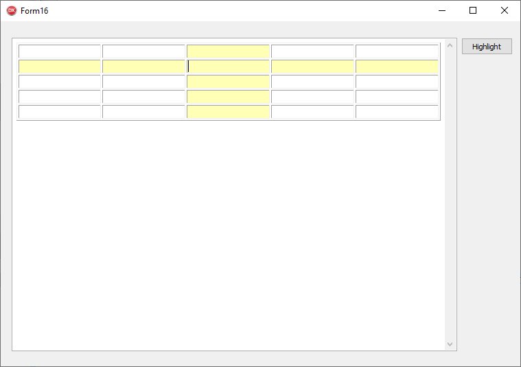

Does really nobody know what a solution could look like, if you click in a rveTabelle (rve: RichViewEdit) to get the 'cross' - in the intersection of which the focused cell is located?
My solution requires 2 steps:
1. Click on the cell
2. Click the switch '.sbTabZeilefaerbenClick'.

Attached.
I used OnRVMouseDown (with ssDouble in Shift check) instead of OnRVDblClick, because OnRVDblClick is not called when users click on an empty space.
HighlightCell.zip
(50.03 KiB) Downloaded 2086 times

Posts: 17877
Re: Marking the whole table row and the whole table column of a focused table cell
In my demo, this highlighting works both when you click on the button and when you double click in the cell.

Posts: 17877
My example does not require to press Shift key.
The check
  if ssDouble in Shift then
in OnRVMouseDown allows detecting a double click. Shift is the parameter name, not the Shift button.
To detect only left mouse button double click, the condition must be changed to:
  if (Button = mbLeft) and (ssDouble in Shift) then
But I found a bug in the code. rveTable.GetNormalizedSelectionBounds must be moved before try...except, otherwise an exception may occur when the caret is to the left or right side of the table (because rveTzeile1, rveTspalte1 will not be assigned in this case).
I attached a fixed version.
HighlightCell2.zip
(50.04 KiB) Downloaded 2239 times
