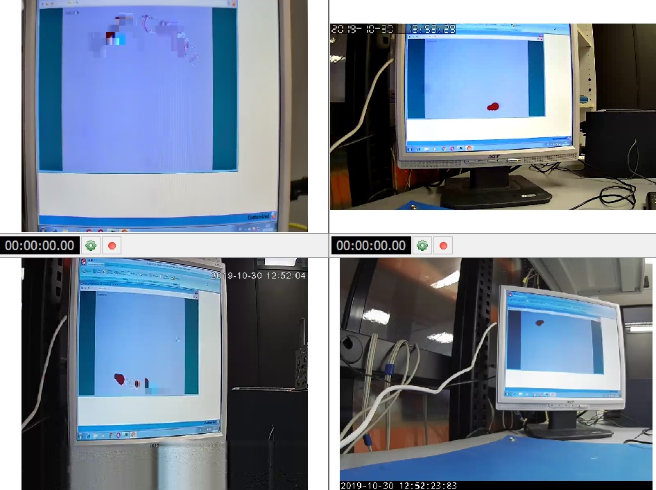

I'm using the demo application ffmepg RVMEDIA V6 on XE10.2 to connect four rtsp network cameras. As a result, the streaming is not smooth but the worst thing is that artifacts appear in the image, as if the decoder was missing packages to paint. All the cameras point to the same scene but in the received streaming you can see a big delay between the different cameras. sometimes more than two seconds.
But, if I open several cmd windows and run ffplay using the same ffmepg libraries as the ffmpeg-demo appplication, this doesn't happens.
start cmd /k ffplay rtsp://10.30.40.81:554/onvif1
start cmd /k ffplay rtsp://10.30.40.82:554/onvif1
start cmd /k ffplay rtsp://10.30.40.83:554/onvif1
start cmd /k ffplay rtsp://10.30.40.84:554/onvif1
I mean, the streaming is smouth and the images are clear and sharp, with no artifacts.
The artifacks I'm talking about looks like the "Testing RVCamera - Video blurred". but sometime it is worst!
Is there a way to config the FFMpegProperty in order to avoid these artifacts? And reduce the delay?

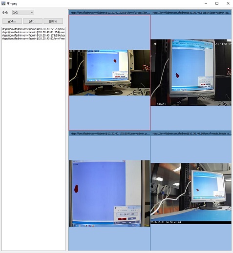

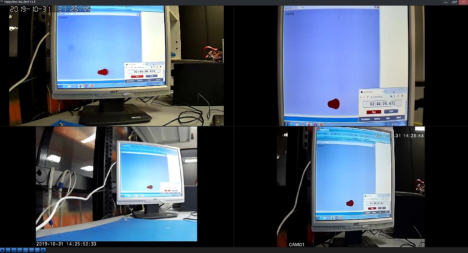

I've tried the latency=0 options with the same results. it is, RVMedia v7 ffmpeg demo project, and four cameras pointing to the same scence are displayed with a increasing latency/delay and depicting image artifacks that other tools (ffplay.exe/rtsp-client-demo.exe) using the same ffmepg libraries (ffmpeg-4.1-win32-shared from Zeranoe FFmpeg Builds <http://ffmpeg.zeranoe.com/builds/>) doesn't (see attached screenshots).
How can it be possible? How can I fix that?
Thanks,

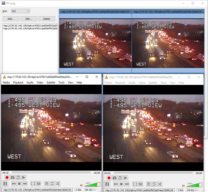

You can use this public trafic camera:
rtsp://170.93.143.139/rtplive/470011e600ef003a004ee33696235daa
and run FFMpeg multiview adding two times the same url.
if you let the program running for a while (3 minutes or so) the image starts freezing and finally it stop playing in one of the viewer.
At the same time I have running two instances of VLC using the same url with no interruption.
Do you still think there is nothing in the RVCamera component?

Re: RTSP H264 decoder generates image artifacts
I am trying to reproduce this problem (using the compiled version of FFmpeg demo for v7.0).
Currently, videos displayed for about 20 minutes.
In my test, VLC shows even more delay than our demo (yes, slightly more delay in VLC).
However, it really displays video more smoothly (in our demo, sometimes video stops for a moment and then played more fast to compensate).
We will investigate it further...
