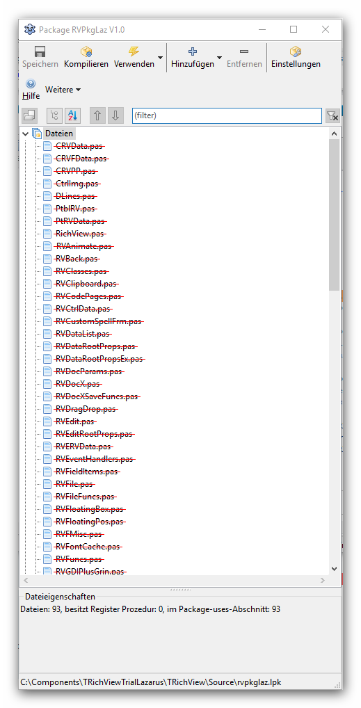

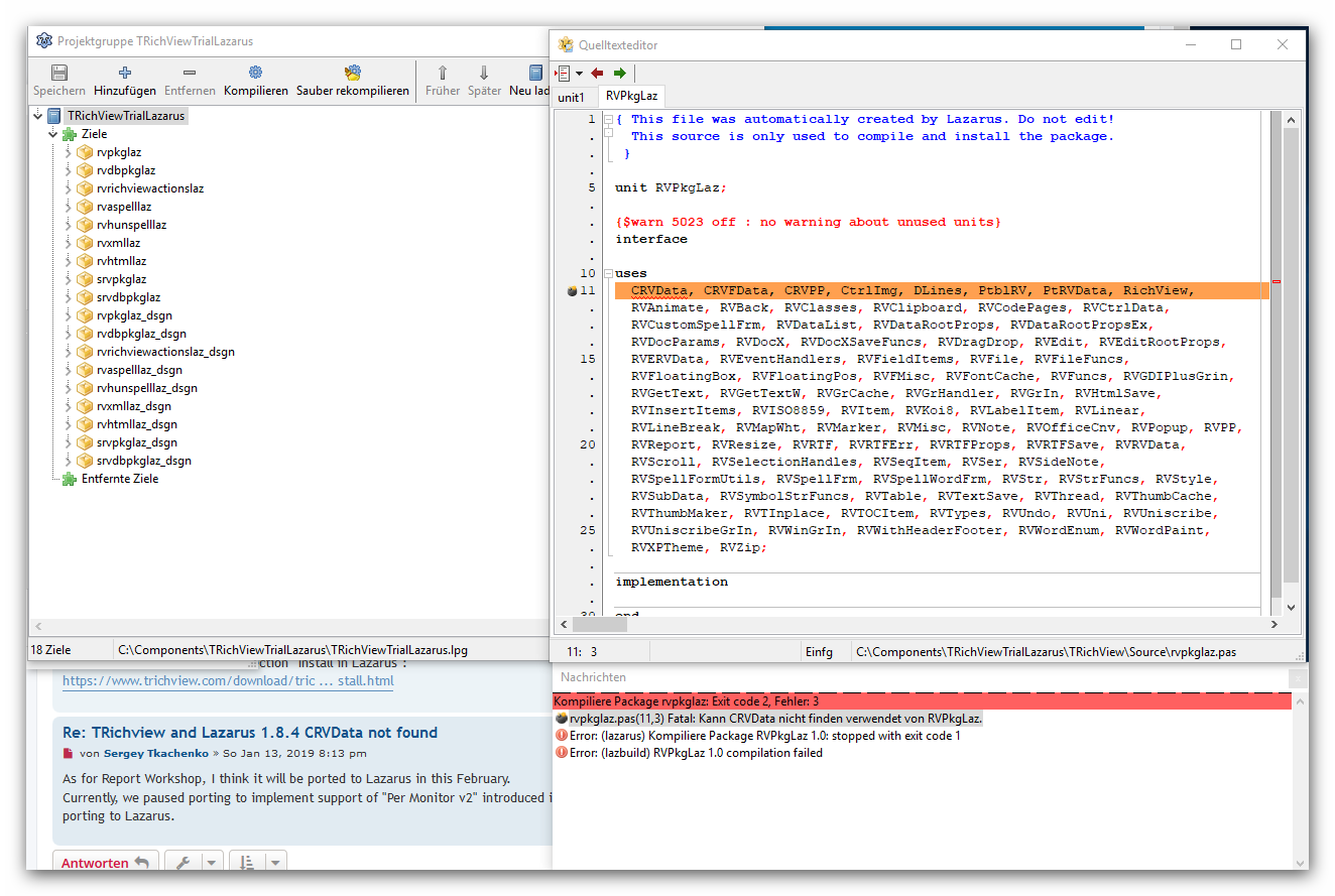

I have tried to compile the project group. Error message is attached.

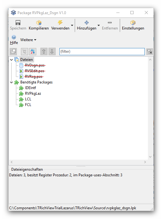

Additonal I have tried to compile both .lpk files manually. This was not possible. The package mangager shows files with an error. Screenshots attached.
I have used the latest trial from yesterday.

It's ok that the package manager shows unit names as a strikethrough text: this is not an error, this means that source code is not available.
But there are compiled files:
- for 32-bit Lazarus, they are in <TRichView Dir>TRichView\Source\lib\i386-win32\
- for 64-bit Lazarus, they are in <TRichView Dir>TRichView\Source\lib\x86_64-win64\
Compiled files must be enough
Please check, are CRVData.ppu and CRVData.o there?
Maybe you used "Recompile Clean" command? This command must not be used for trials, it deletes trial files.

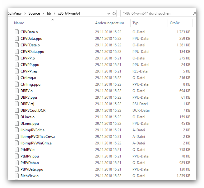

Files are there. Attached some file information.
I have used "compile" only. "Clean compile" not touched.

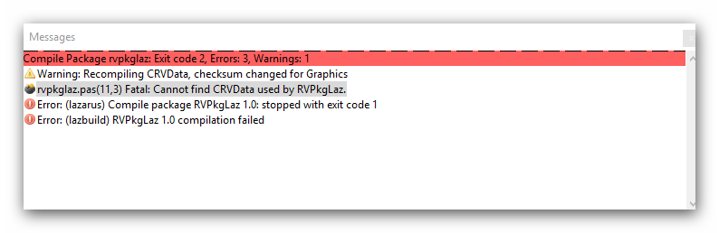

After switching Lazarus IDE to English it says something, that the checksum for graphics has changed and a recompile is needed. Details attached.

Re: TRichview and Lazarus 1.8.4 CRVData not found
I think it means that your version of Lazarus / FPC is not exactly the same as it was used to compile the trial version.
Check the Lazarus About box (menu Help | About Lazarus).
The trial was compiled with:
Version #: 1.8.4
Date: 2018-07-28
FPC version: 3.0.4
SVN Revision: 57972
Or maybe you applied some patches that changed LCL files?
Version #: 1.8.4
Date: 2018-07-28
FPC version: 3.0.4
SVN Revision: 57972
So you have the same version...
Sorry, I do not know why Lazarus finds that checksum of LCL units are different in your and my copies of Lazarus.
I can only imagine that you might installed some patches of third-party libraries that modified LCL code.
The full version is distributed with the source code, so this problem does not affect them.
