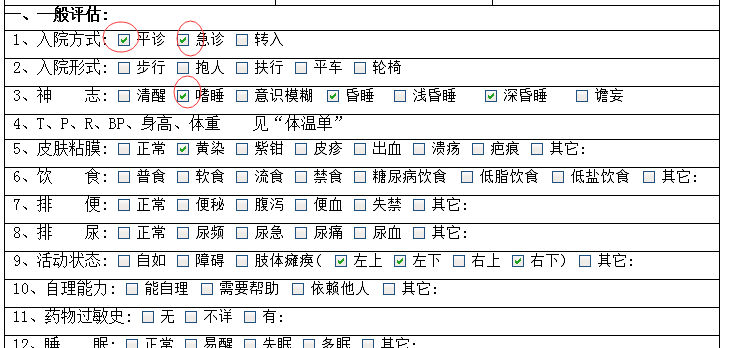

Currently, the TSRVComboBox control in the printed file is still in color, can it not be modified?

Thank you very much, waiting for your presentation... I'll show you a screenshot of the color of the control.
- QQ图片20170727091225.png (28.81 KiB) Viewed 58444 times
