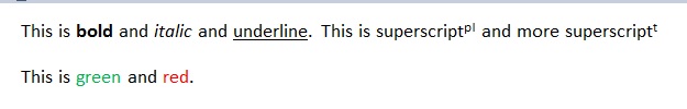

I want trichview component placed at the bottom of my form. While a user is putting data into some editfields the exit eventhandler calls a procedure coding for rtf-text in this trichview.
Could you give me an example of how to code into trichviw the attached text Delphi.
I presume that when saving this text as RTF the superscrip will persist?

Do you want an example how to generate such document in code?
Yes, sub/superscripts are stored in RTF

A sample project creating this document in code is attached.
