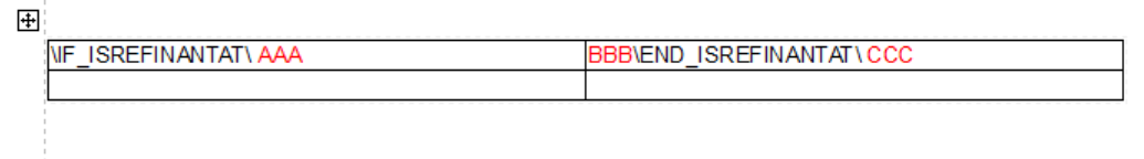

I tried this code and if the delimiting words are in different cells, and there are other words after the first one, the delimiters are deleted, but also what is between them.
How can I delete delimited text when it is in different cells?

What does "content between cells" mean? If the cells are in different rows and columns? If they are in different tables, maybe nested in each other?

Theoretically it should delete everything between the two keywords, true, it could be on other rows, but never in different tables.

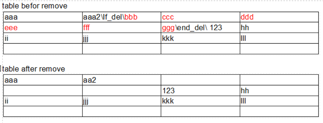

Like this demo, remove all item between \if_del\ and \end_del\

Re: Deleting a range
The code supporting starting and ending codes in different cells is below.
This kind of selection (from the starting cell till the end of the row; then all cells in the rows between; then cells till the ending cell) is not natural for TRichViewEdit: TRichViewEdit selects cell that are inside the specified rectangular area.
As a result, all cells need to be cleared one-by-one; and the code became large.

Yes, now it detects the two keywords in the text ok, but the problem remained with detecting keywords in tables an remove text in cells.

I managed to test your code and from the first tests it works perfectly. I will have to check in more detail the combinations that can occur when calling the function in combination with my code to adapt it to the needs of my application.
Thanks again for the effort and help.
