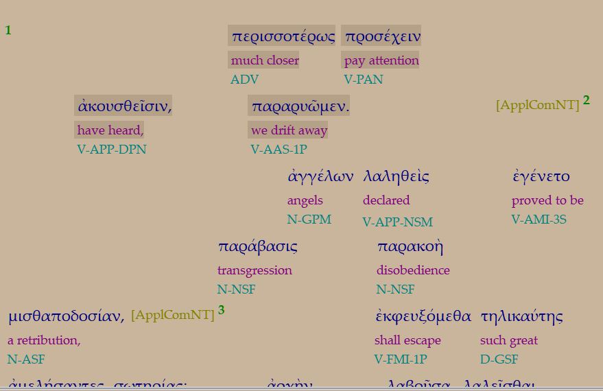

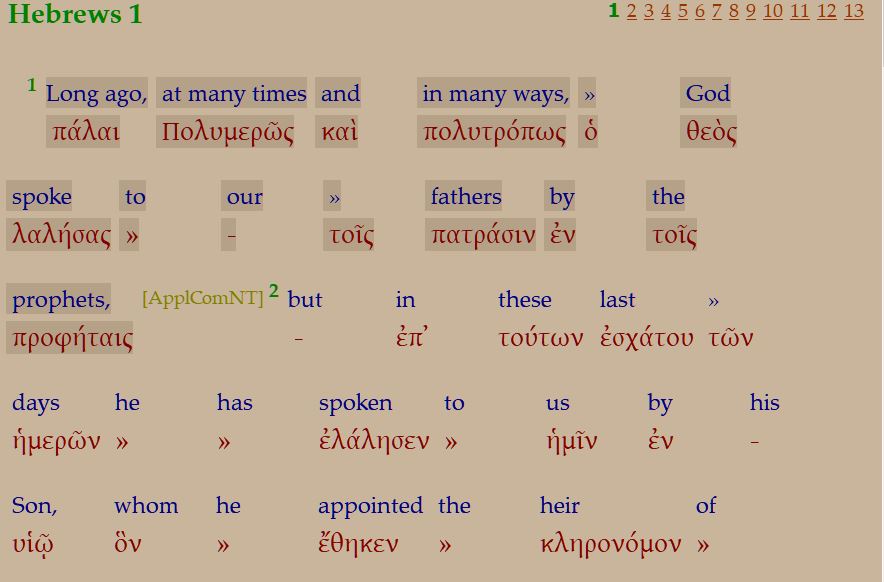

Post by jgkoehn »
I am working with these subEditors and it is going quite well. (I am needing to speed them up there can be a lot.)
I am having trouble with DocmentWidth (note I am on rvf17 on this project)
rvS.Width := rvS.RVData.DocumentWidth;
It is resizing but not fully always.
I've tried +/- [rvoClientTextWidth];
I've set this for the subEditors options: rvS.Options := rvP.Options - [rvoClientTextWidth];
jgkoehn
Posts: 325
Re: [Demo] Editors in editors
Post by jgkoehn »
If you could help me to get the leanest/quickest version of:
rvS.FormatTail;
rvPd.AddControlEx('subEditor|row:' + IntToStr(rowIdx) + '|grp:' + IntToStr(i),rvS, -1, rvvaAbsTop);
As in do I need to clean up styles, what options, for TRichViewEdit. etc can I use to get it there the fastest.
I have a bout a 11sec delay on load and I need to get this down to like 1 sec if possible.
I am adding roughly 100s of TRichViewEdits depending on the Chapter length. So that means I am calling Format/FormatTail that many times for each indvidual TRichViewEdit that is added. Also calling AddControlEx

jgkoehn
Posts: 325
Post by jgkoehn »
  //Special for Interlinear
  ReadOnly := True;
  HScrollVisible := False;
  VScrollVisible := False;
  BorderStyle := bsNone;
  WordWrap := False;
  TopMargin := 0;
  BottomMargin := 0;
  LeftMargin := 0;
  RightMargin := 0;
WordWrap should be set to False hmms...
As to efficiency here is the process.
1. The RVF document is loaded with items.
2. I process a paragraph. Not there could be a 151 pagraphs I think max.
3. Then using the items in the pagraph. I add them to a subEditor if they are what I want I add them using AddNLW. Items not needed are added back into the paragraph not to the subEditor.
4. Then once the correct items are added to the new subEditor. The subEditor is formatted (not the main editor)
5. Then this new subEditor is added via AddControlEx.
6. Once the paragraph is compled I delete the original items DeleteItems. Since they are now stored in the subEditors. Could be 20 or more subEditors in a paragraph.
Format for the main TRichViewEdit is called after the whole document is built. With the exception of the subEditors they are formated before they are added or they seem not have the right heigth/width. Hmms maybe this Format for these subEditors is slowing it down and the main Format is all I need. But how can I get the right Width/Height? Do I need to go through all the subEditors and resize after the main format?
By the way once they are generated it works very nice.
