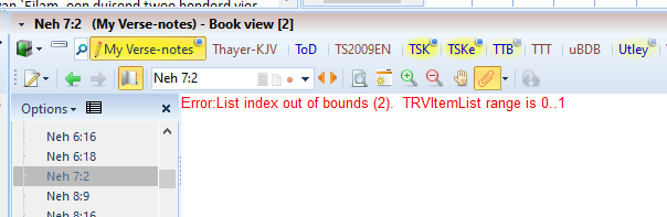

Is this related Sergey?
It is showing up in the Richview interface but not always.
Screenshot 2025-07-13 072233.png (30.67 KiB) Viewed 173190 times

It is highly possible I've done something wrong and just have no idea on how to get to the bottom of it.
Re: Bad RTF table causing RichView to error
If the error text is shown on TRichView itself, this mean that an exception happens while drawing content.
Most probably. it happens because TRichView is not formatted.
Do not forget to call Format after loading.
Please create a compliable project reproducing the problem and send it to me.
I am afraid, without reproducing the problem, I cannot help.
I cannot even understand the problem. First, the topic was about a (handled) error when loading RTF. Then about exception on drawing. Then an error in a code executed on a timer.
1) If the exception on pasting happens in RTF loading code, it must not affect subsequent drawing. On exception, RTF loading is aborted, but the items that are already added must be formatted and must be displayed correctly.
If the error happens on some specific RTF, please send this RTF to me. If it happens only on pasting, you can use this utility to save RTF from the Clipboard to a file: https://www.trichview.com/support/files ... ofile2.zip
2) TRVItemList is a list of items in the document (an item can be: a text item, a picture, a table, etc,). This is a type of TRichView.RVData.Items.
If the error on your screenshot shows that you have only 2 items in your document (indexes 0 and 1), but some code tries to access the item with the index 2 (that does not exist) while drawing.
3) The comment says: "causing a TRVItemList error cascade." I understand that it means that is a repeating error. The error can be repeated if it occurs while drawing. But you said that your code is executed on timer, so the error in this code must not be repeated.
Can you post a call stack window content at the moment of this exception?

  //with reader.Style do
    if Assigned(FCurModule) then begin
      //user module: remove protection
      if FCurModule.IsUserModule then begin
        for i:=0 to reader.Style.TextStyles.Count-1 do
          reader.Style.TextStyles[i].Protection := [];
        for i:=0 to reader.Style.ParaStyles.Count-1 do
          reader.Style.ParaStyles[i].Options := reader.Style.ParaStyles[i].Options - [rvpaoReadOnly, rvpaoNoWrap,
              rvpaoDoNotWantReturns];
      end
  // After paste
  NewItemCount := reader.ItemCount;
  // Normalize selection
  sItemNo := FAfterPaste_sItemNo;
  eItemNo := FAfterPaste_eItemNo;
  sItemOffs := FAfterPaste_sItemOffs;
  eItemOffs := FAfterPaste_eItemOffs;
  CurItem := FAfterPaste_CurItem;
  OldItemCount := FAfterPaste_OldItemCount;
  if sItemNo > eItemNo then
    Swap(sItemNo, eItemNo);
  if (sItemNo <> eItemNo) or (sItemOffs <> eItemOffs) then
    minIndex := sItemNo;
    replacedCount := eItemNo - sItemNo + 1;
    pastedCount := NewItemCount - OldItemCount + replacedCount;
    maxIndex := minIndex + pastedCount - 1;
  end
  else
    pastedCount := NewItemCount - OldItemCount;
    if pastedCount <= 0 then
      minIndex := -1;
      maxIndex := -1;
    end
    else
      // If selection was "select all", pasted items start at 0
      if (sItemNo = 0) and (eItemNo = OldItemCount - 1) then
        minIndex := 0
      // If caret was at start, pasted items start at 0 (offsets are 1)
      else if (sItemNo = 0) and (sItemOffs = 1) and (eItemNo = 0) and (eItemOffs = 1) then
        minIndex := 0
      // If caret was at the end, pasted items start at OldItemCount
      else if (sItemNo = OldItemCount - 1) and (sItemOffs = Length(reader.GetItemText(sItemNo)) + 1) then
        minIndex := OldItemCount
      // Otherwise, pasted items start at caret position
      else
      // Clamp minIndex to valid range
      if minIndex >= NewItemCount then
        minIndex := NewItemCount - pastedCount;
      if minIndex < 0 then minIndex := 0;
      if maxIndex >= NewItemCount then maxIndex := NewItemCount - 1;
  if (minIndex >= 0) and (maxIndex >= minIndex) and (maxIndex < NewItemCount) then
    for i:= minIndex to maxIndex do begin //JGK was CurItem+reader.ItemCount-ItemCount+1 do begin
      // Double-check bounds before accessing
      if (i >= 0) AND (i < NewItemCount) then begin //just to be sure...
          //SHIFT not pressed (UP)
        if GetKeyState(VK_SHIFT) and $ff00 = 0 then begin
          try
            s := reader.GetItemTag(i);
            p := Pos(':', s);
            if (p>0) and(p<6) then continue;
            //reader.SetItemTag(i, 'REMOVE_ME_' + IntToStr(i));//<------------This can be used instead because it keeps the tags unique and so they don't get conceated in the Normalize I believe.
            reader.SetItemTag(i, ''); //<---------IF this is removed then there is no error.
          except
            on E: Exception do begin
              debugOnScreen(PChar('DoAfterPaste GetItemTag error: ' + E.Message));
              Continue;
        try
          // Validate style index before accessing
          if (reader.GetItemStyle(i) >= 0) and (reader.GetItemStyle(i) < reader.Style.TextStyles.Count) then begin
            if reader.Style.TextStyles[reader.GetItemStyle(i)].Jump then begin
              if (Pos('REMOVE_ME_', reader.GetItemTag(i)) > 0) OR (reader.GetItemTag(i) = '') then
                reader.Style.TextStyles[reader.GetItemStyle(i)].Jump := False;
            end
        except
            debugOnScreen(PChar('DoAfterPaste TextStyles error: ' + E.Message));
            Continue;
        //if pasting tables, add the rvtoEditing (see  http://www.trichview.com/forums/viewtopic.php?p=10747#10747)
        //bug when pasting from compare view to book view
        try
          if reader.GetItemStyle(i) = rvsTable then
            with TRVTableItemInfo(reader.GetItem(i)) do
              Options := Options + [rvtoEditing];
        except
            debugOnScreen(PChar('DoAfterPaste Table error: ' + E.Message));
            Continue;
        //remove checkpoint when pasting from bible view
        try
          cpd := reader.GetItemCheckpoint(i);
          if ( cpd<>nil ) then begin
            reader.GetCheckpointInfo(cpd, RVTag, name, re);
            if GlobalUtils.StrSameStartU('_TW_VLIDX', RVTag) then
              reader.RemoveCheckpointEd(i);
        except
            debugOnScreen(PChar('DoAfterPaste Checkpoint error: ' + E.Message));
            Continue;
      end;//To make sure we are inside of range
  //if SHIFT is down, fix e-Sword style links: for pasting from eSword
  if GetKeyState(VK_SHIFT) and $ff00 <> 0 then begin
      if not FixEswordLinksOnPasteRE.IsInit then
        FixEswordLinksOnPasteRE.Create(gc_AutoRefRegex, [roCompiled]);
      if maxIndex >= minIndex then begin
        RVIterateAllItems(reader.RVData, [], DetectVRefsOnPasteCB, 'DoAfterPaste minIndex to maxIndex', minIndex,
          maxIndex);
      end else begin
        // Fallback: use full range if calculation fails
        minIndex := 0;
          RVIterateAllItems(reader.RVData, [], DetectVRefsOnPasteCB, 'DoAfterPaste minIndex to maxIndex', minIndex, maxIndex);
        debugOnScreen(PChar('DoAfterPaste: Used fallback maxIndex ' + IntToStr(maxIndex)));
      cmdAutoDetectVREFsClick(nil);
  reader.format; //<----------------------This doesn't seem to do anything
  reader.RVData.NormalizeDocument(0,True); //<-----------This triggers the error (I put it here normally it is in some other function and so happens later at various times depending on what a user does.
