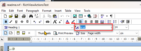

If I load the richviewactiontest demo and start the project. Now the font combobox has selected text.

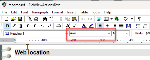

If I open the richviewactiontest demo from the richviewedit and start the project, the font combobox is not selected.
Richview FontComboBox.png (19.45 KiB) Viewed 74515 times
Is there a way that the fontcombobox has no intial selection?

The demo uses a workaround,
const
    WM_DESELECTCOMBO = WM_USER + 1;
In the form's interface section:
procedure WMDeselectCombo(var Msg: TMessage); message WM_DESELECTCOMBO;
procedure DeselectComboBoxes;
Implementation:
procedure TForm3.DeselectComboBoxes;
  cmbFontSize.SelLength := 0;
  cmbFont.SelLength:= 0;
// The font combo box is displayed selected on start. Hiding its selection.
procedure TForm3.WMDeselectCombo(var Msg: TMessage);
  DeselectComboBoxes;
PostMessage(Handle, WM_DESELECTCOMBO, 0, 0) is called on FormShow and FormBeforeMonitorDpiChanged.
DeselectComboBoxes is called in btnLanguageClick.
