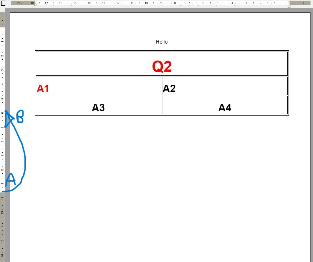

I must be able to move the SclRvRuler1 from point A to point B by code!. The document contains a single Page.
The point B should be at the Bottom of the last item in the SRichViewEdit1 page, in this case a table1.
By the following line :
SclRvRuler1.BottomMargin:=SclRvRuler1.BottomMargin+1;
I could move the bottom of the SclRvRuler1 upword by one point!
Please I need to know how to choose the correct "step" (distance in points between A an B) so I can accomplish that in one step?
SclRvRuler1.BottomMargin:=SclRvRuler1.BottomMargin+Step;
It is a task I requested in previous post without having a satisfying answer.
I believe in your Abilty Sergey, Please would you try to figure out a solution for this issue?! Step:=????????
Thank you in advance!!
Screenshot 2023-09-13 173851.jpg (59.24 KiB) Viewed 47934 times

I need to calculate NewMarginValue so the BottomMargin(Presented By the Letter 'A' in the ScreenShut I sent) will jump just after the table item in my document. It is vital for me to do that bycode!!

In which units Y coordinates of A and B are specified? In screen pixels? Or maybe in the ruler units (I can see centimeters on your screenshot)?

Pixels...
when I execute the Line SclRvRuler1.BottomMargin:=SclRvRuler1.BottomMargin+1; the BottomMargin jump one pixel upword.
I need to know how many pixels there are between points A and B...
I could retrieve the itemRect of the last item(table), then it seems that I should deal with (BottomMargin-ItemRect.Bottom) in the following way
SclRvRuler1.BottomMargin:=SclRvRuler1.BottomMargin+(BottomMargin-ItemRect.Bottom)
The Bottommargin moves close to the bottom of table1 but not exactly!
