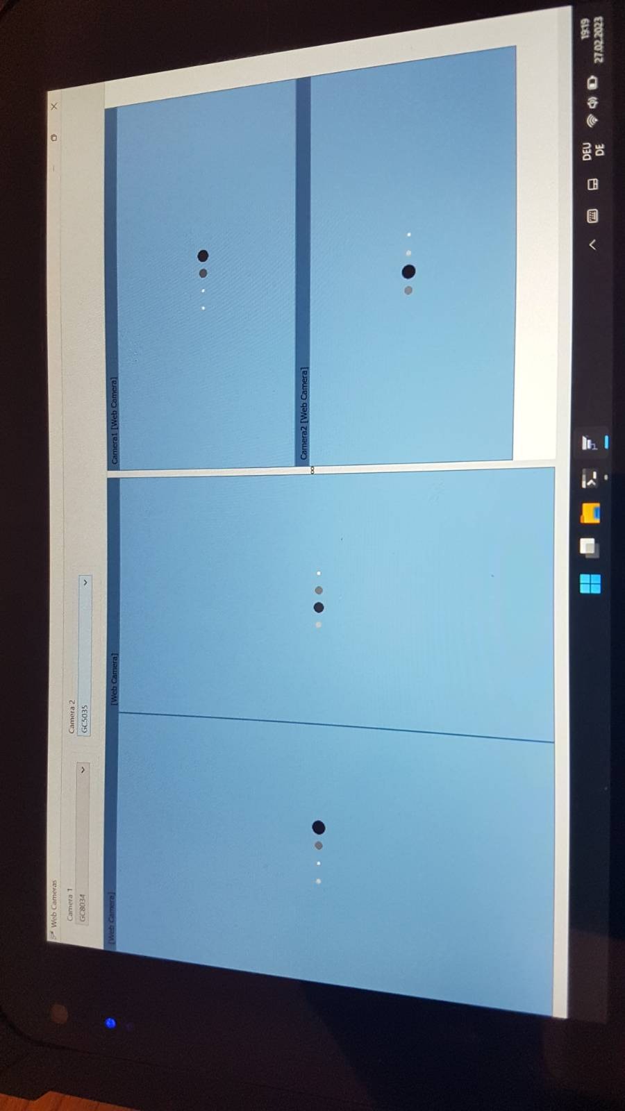

I just had some good progress in programming with the rvmedia suite . but currently I´m stuck in an issue regarding my front and rear camera on a windows tablet:
The tablet runs Windows 11 Pro.
I use the Webcam demo and also the WebcamMulti demo
Both run on my developer notebook as expected (webcam [just one] is shown on the app window)
Now I run the same exe on my Windows tablet and it shows both cams (front and rear named GC8034 and GC5035) --> this is correct so far
But when I select those cams I get the progress points and nothing happens any more...?
Any suggestions what could be wrong?

- screenshot
- signal-2023-02-27-191937.jpeg (97.59 KiB) Viewed 296110 times

Re: RVCamera Demo for Webcam not showing up on Windows tablet
Good evening,
Yes I have already tried the WebCamera demo as well and had the same results. No matter what I selected on the tablet, I got same results with each configuration.

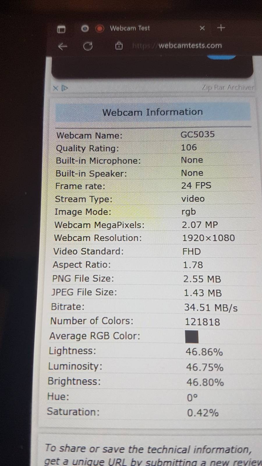

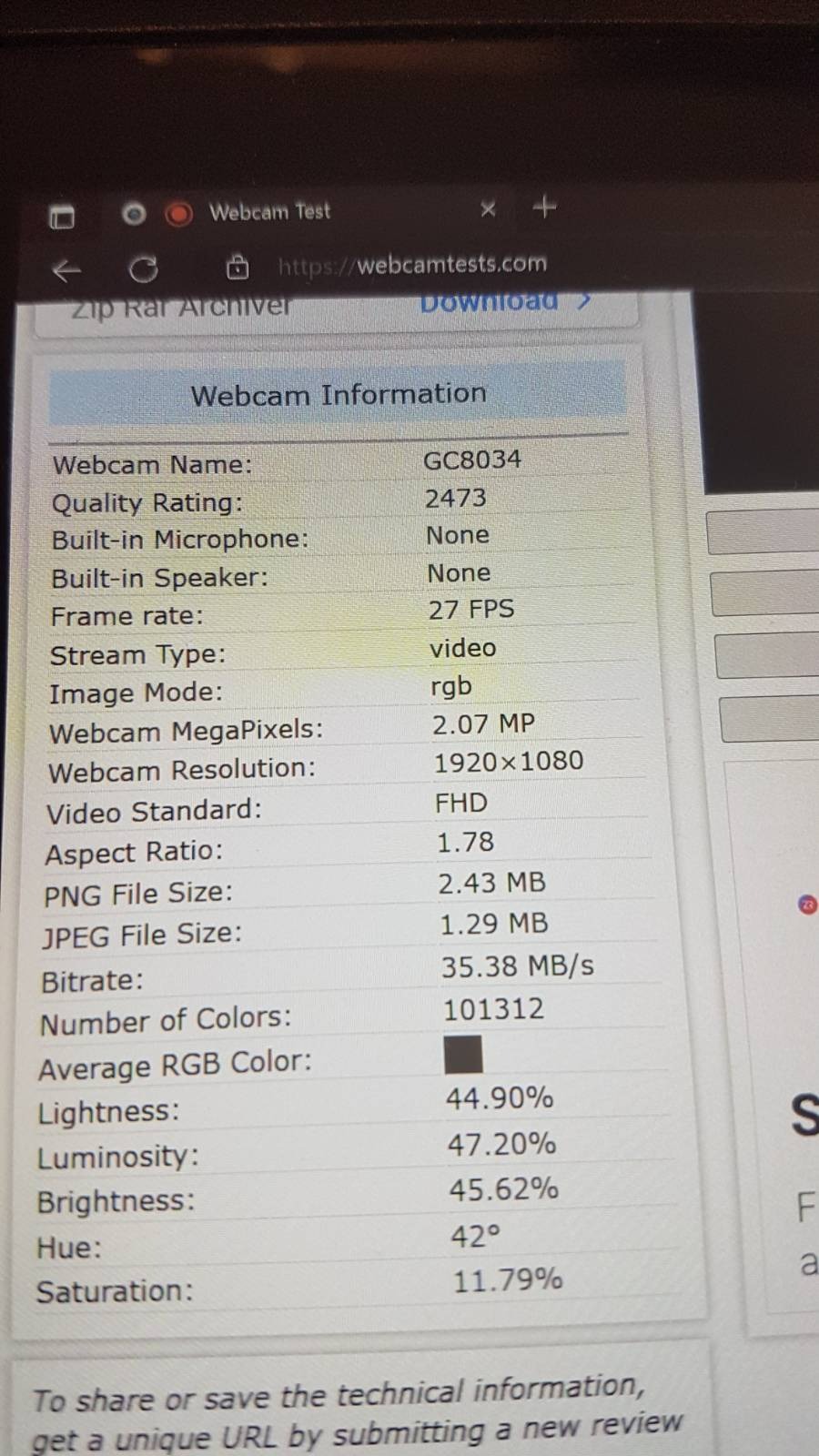

Just went through the blog and found a similar post (at least the result on the desktop):
viewtopic.php?p=41495&hilit=webcam#p41495
I checked the DirectX with DxDiag but no fail.
And I checked with the webcamtests.com site and got no failures.
- signal-2023-03-02-170138_003.jpeg (205.57 KiB) Viewed 296031 times
