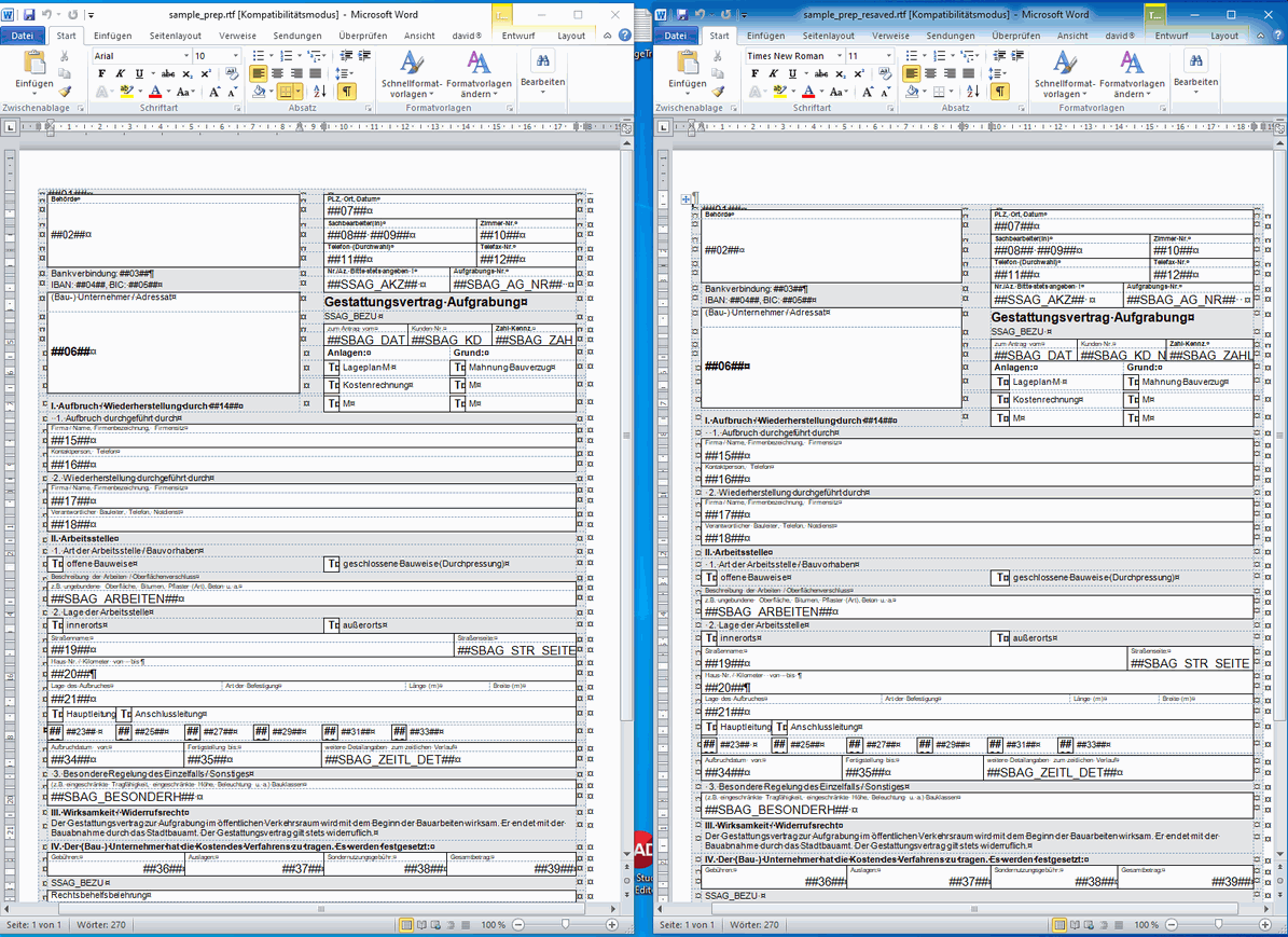

Extra Paragraphs, just load / save rtf to rtf/docx?
One more,
if I load a RTF file from our pool - for example with the ActionTestUni Sample - and save it to rtf or docx - there is one / some new paragraphs generated which leads to new pages in the document if we open it again with MSWord oder LibreOffice - any idea or hint how to avoid this?
in these screenshots the left side shows the original RTF - right is the new saved rtf / docx
André
André
- pngdocx2.png (134.95 KiB) Viewed 36044 times
- pngdocx1.png (146.23 KiB) Viewed 36044 times

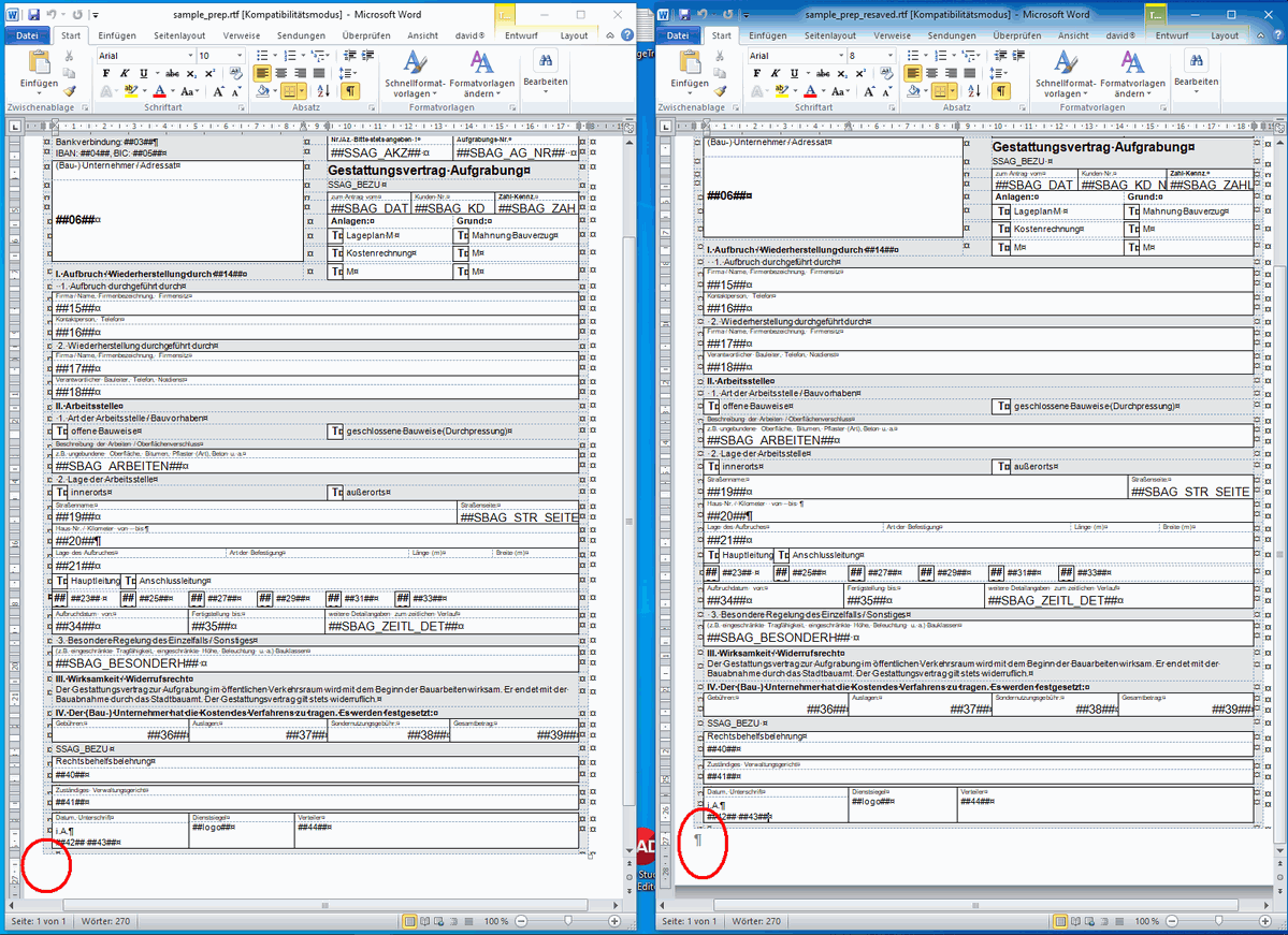

Re: Extra Paragraphs, just load / save rtf to rtf/docx?
Hello Sergey,
I have found the reason for this problem - the source document uses distance of zero from the page border for header / footer. But the Value if zero is not used by the reader.
Please have a Look into "RVRTFProps.pas" - I have modified the function
in this way - original:
to this
Is this the right way to fix this or do I miss something? (Whats about RVF need that fixing too?)
André

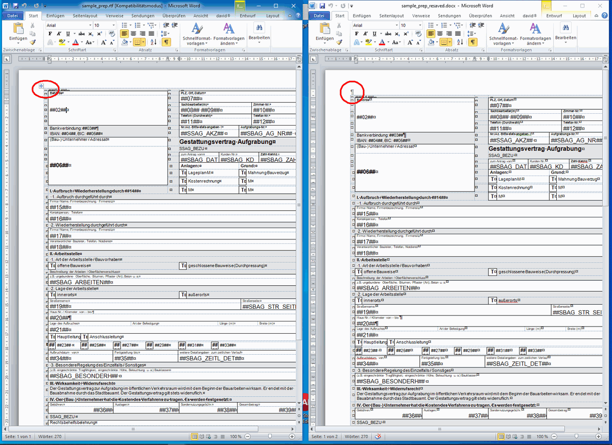

ok - the zero distance was part one of the issue - part two are the extra created paragraphs inside Header / Footer - headers and footers are allways saved also if they are empty - disabling the header/footer with the option [rvrtfSaveHeaderFooter] is no solution, because we will have sometime headers or footers but not both.
Most code uses the function to test if there are headers or footers - but this function does only test if the RVData of one of the HF / subdocuments is <b>nil</b> instead of is nil and RVData.isEmpty().
Changing this function will break the RTF reader I think (TRVRTFReaderProperties.InitReader) - because there is this test used before loading if the Header/Footer etc. objects are initialized and if they should be loaded from the RTF Stream? May be we need another? as decision helper for the saving code - if there is really a header or footer needs saving?
But this will be only a part of the solution - before saving any header / footer should be a check if it is empty in any case?

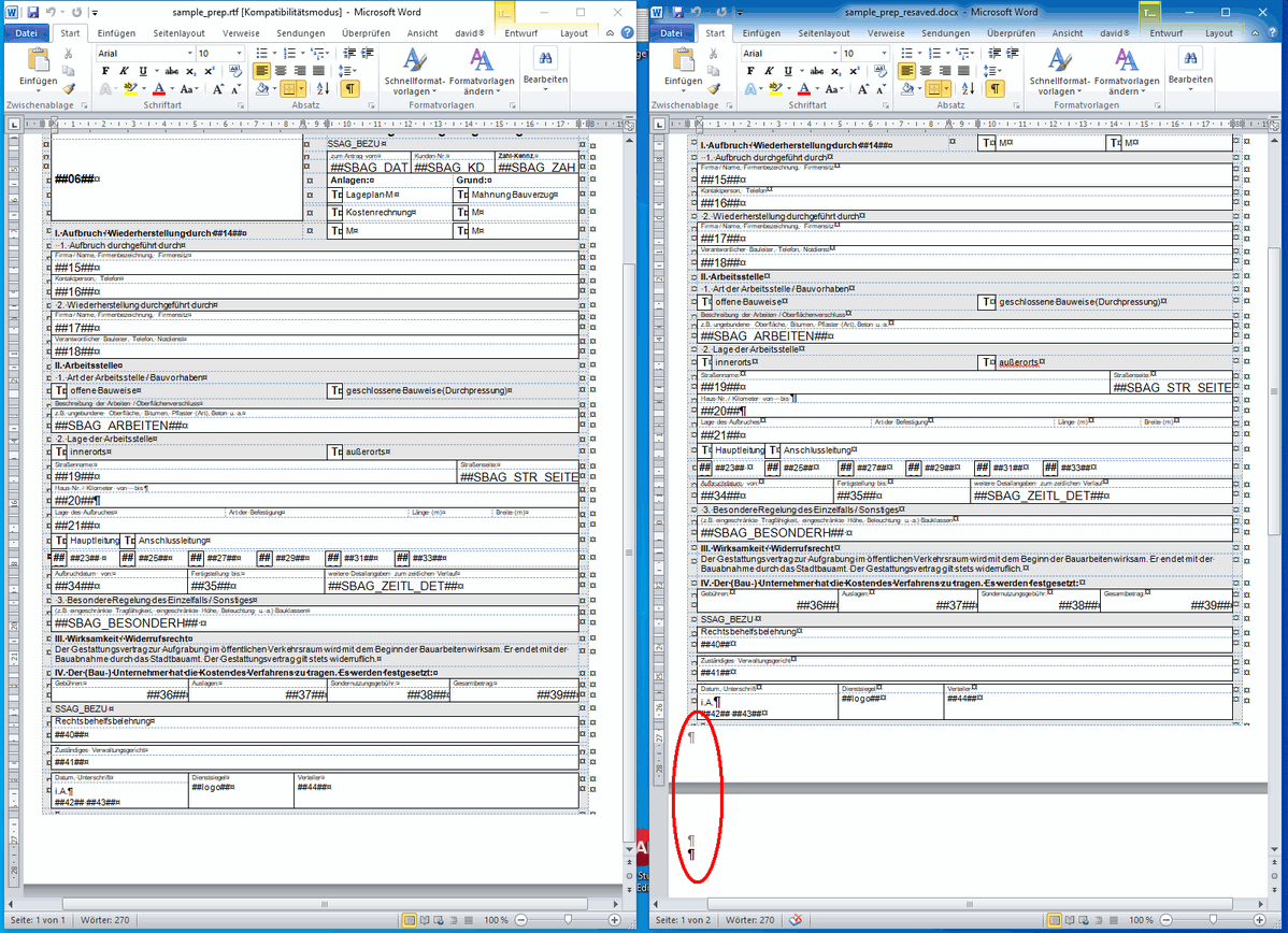

The extra paragraph in the DocX which cause the pagebreak - comes from an empty textelement.
The template contains at rootlevel two <TCustomRVItemInfo> the first is the table containing most / all of the content.
And second a very small nearly invisible TRVTextItemInfo with no text and a fontsize of 1.
This is written to the document.xml as
as long there is no text inside the <w:t> tag - word inserts a linefeed with the big font instead of the size 1 -- if I fake the xml
to this and insert a "-" - word renders the document as expected?
Do you any idea if this may be a bug in Word or at your side? If Word itself converts the original RTF to DOCX this paragraph is encoded in this way:
There is a <pPr> instead of your run <r> and no <w:t>?
Any help / idea is apreciated. For the moment I will write a small loop which deletes from the end all empty Items - like a "rtrim" I hope that works.
Sorry: Deleting the empty items before save avoids only its encoding into the document.xml but the linefeed / pagebreak in word is still there.
The last paragraph after the table in the docx is written as this:
as long there is no real text inside <w:t> my MSWord generates this extra paragraph from this?
EDIT: My MSWord is an old one 2010
EDIT: If I look at the table properties in Word they are the same as before - so I don't know why Word renders the newly written RTF other then the original - the width of the table is changed by one time the border width. (If I use a table with one column and two rows and a borderwidth of 6pt)
