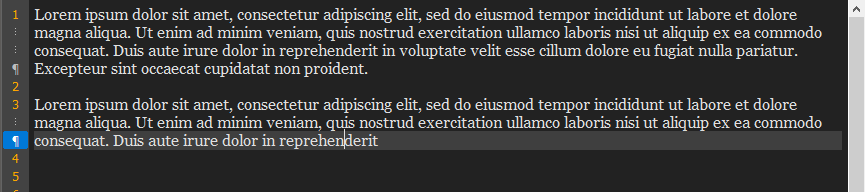

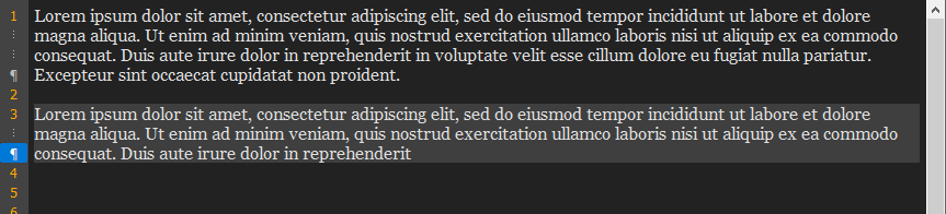

I'm trying to set up a slightly different paragraph highlight and can't figure it out.
Here's what I have now, it works fine (call this paragraph highlight):
Here's the relevant code:
    r := ARect;
    ACanvas.Brush.Color := SRDJournalThemes.EditorActiveLine;
    ACanvas.FillRect(r);

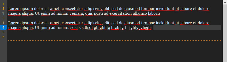

What I want is to add being able to do this (call this line highlight):
Here's that code:
    r := ARect;
    yoffset := ( Edit.VScrollPos * Edit.VSmallStep );
    CurDItem := TRVEditRVData(Edit.RVData).CaretDrawItemNo;
    Edit.RVData.GetLineVerticalBoundsOrigEx(CurDItem,LineTopY,LineBottomY,CurDItem,CurDItem);
    r.Top := LineTopY - yoffset;
    r.Bottom := LineBottomY - yoffset + 1;
The problem is when I start typing or turn live spell on and off. The line highlight flickers and even drops out:

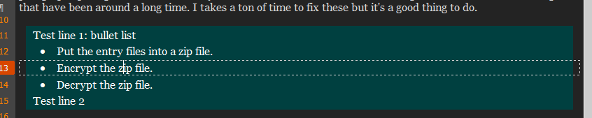

I have worked around my issue of trying to highlight a single line using DrawParaBack by using a different approach. Instead of changing the para back to highlight a single line, I used the regular rve onpaint and add a dotted rectangle around the current line like this:
The advantage with this is it works "on top" of paragraphs with background colors and it still works with paragraphs I highlight using DrawParaBack as before. So I don't have to pick one or the other, I can have both. Or none of course!
If you get the para back working though, that would be a plus. If not, this should do.
