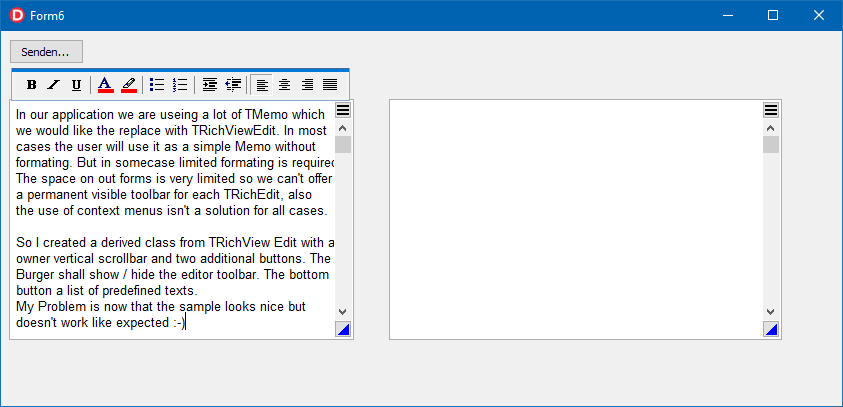

Hello Sergey,
I want to replace a lot TMemo controls in our forms - with TRichViewEdit and a limited set of formating possibilties for our users. The available space on our forms is very limited, so we tried this. I did create a new subclass from TRichViewEdit in the constructor I disabled the original vertical scrollbar and created a new one of your TSRVScrollBar and two additional buttons on top and bottom of it. Now it looks like this at runtime:
The burger button, will show a editing toolbar on top of the control - but not inside the control - so it is nothing you have to worry about,
(the toolbar will be a shared objects for all of our memos and exists only as a single instance)
Looks nice - but doesn't work - I thought it would be enough the override AdjustClientRect() and remove the scrollbar from the "ClientArea" and so
from ClientWidth - but it seems that your painting and calculation isn't useing ClientWidth? or has a copy from it?
So if I type text in single line it will be painted behind the scrollbar.
Also if the richedit starts to scroll verticaly things go wrong - because it tries to scroll also my controls.
(the memo's in that case will use the Option.rvoClientTextWidth = TRUE, to avoid the horizontal scalebar)
Can you offer me some help / hints how to solve this - may I have to override some additional methods to get work?
I have allready found the sample that show's how to use external scrollbars and how to synchronize them with a TRichViewEdit,
that was useful - to keep my scrollbar in sync.
with best regards
André

Re: TRichViewEdit - with own VerticalScrollbar and extra buttons
Children are scrolled in TRVScroller.ScrollChildren.
If it would solve the problem, I can add a virtual method CanBeScrolled(ChildControl: TControl): Boolean and use in this method.
But probably another solution would be simpler: a control that includes both TRIchView and scrollbars as children (this approach is used in DevExpress controls, including TcxTRichViewEdit)

thanks for your response and pointing me to the right source ... I have modified RvScroll.pas in this way:
function TRVScroller.DoAllowScrollChild(const ctrl: TControl): boolean;
  // this is a virtual protected method - which I override in my own class, to decide what is scrolled
  // my be a good idea to also add dx,dy TRVCoord to this callback, to have all information needed to
  // decide about scrolling or not?
  result := true;
procedure TRVScroller.ScrollChildren(dx, dy: TRVCoord);
  i: Integer;
  if RVIsZeroCoord(dx) and RVIsZeroCoord(dy) then
     exit;
  {$IFDEF FIREMONKEY}
  for i := 0 to ControlsCount - 1 do
    if DoAllowScrollChild(Controls[i]) then
  {$ELSE}
  DisableAlign;
  try
    for i := 0 to ControlCount - 1 do
    end
  finally
    {$IFnDEF FPC}
    ControlState := ControlState - [csAlignmentNeeded];
    {$ENDIF}
    EnableAlign;
  {$ENDIF}
I also override TWinControl.GetClientRect - to return only the clientrect without scrollbar so there is no obvious flickering to see.
Only updating the scroll to the correct PageSize/Min/Max seems not the work in all cases - I have to check this.
(Currently I copied your code from the external scrollbar sample, may be I have missed something)
André
