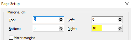

5. Modify the page setup

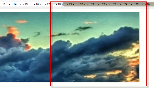

6. Now it should be displayed like this:
7. At the right border you can’t scale the image horizontally or diagonally (horizontal + vertical). The only possible way to scale the image at the right border is vertical.
