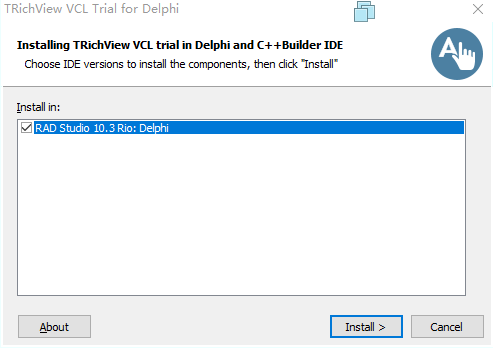

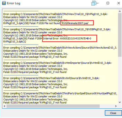

Hi, I try to install the TRichView VCL trail, but failed, the installation environment is win10 LTSC and Delphi10.3.3, its a new environment without other softwares.
- 2.png (36.63 KiB) Viewed 19373 times
- 1.png (11.06 KiB) Viewed 19373 times

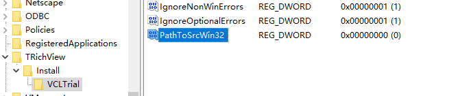

Can you check the value of HKCU\SOFTWARE\TRichView\Install\VCLTrial\PathToSrcWin32 in the Registry?
Re: Trial installed Failed in new system
the value is 0
- 1.png (13.29 KiB) Viewed 19361 times
It's strange, it must be 1.
Please change it to 1 in RegEdit to 1 and re-run the trial again (the full setup).
I'll recheck the installer code to understand how it could become 0.

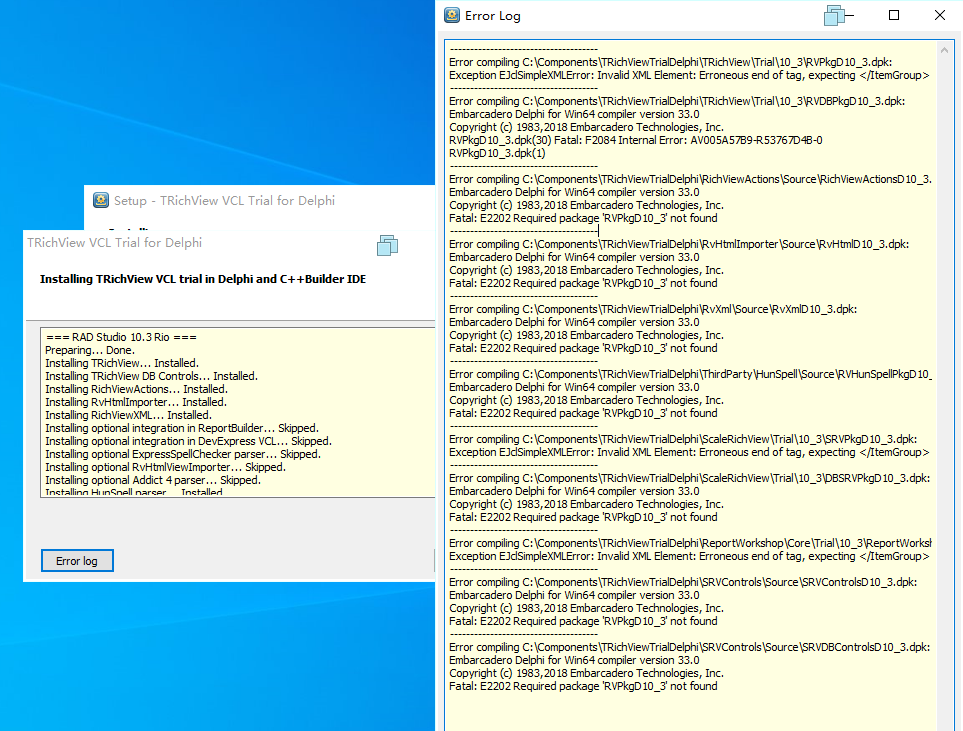

Do you remember what errors? I am interested in all bug reports.
PS: I reviewed the installer code and still do not understand the reason of this problem. There are only 3 places where this option is assigned: initialization (True), reading from registry (but only if the key exists, so it's not for fresh installs), and when clicking the Options button (that must be hidden in the trial installer).
But it was reported twice.
For any case, disabled reading from the Registry in trials and rebuilt the installer. I'll update the new RVMedia trial setups. TRichView trial setups will be updated on the next minor release.
as follows:
- error.png (122.81 KiB) Viewed 19328 times
Please send me the file c:\Components\TRichViewTrialDelphi\TRichView\Trial\10_3\RVPkgD10_3.dproj
I want to understand why it is corrupted.

This obviously a result of applying "PathToSrcWin32=0" to trial packages.
However, this is very strange. While this procedure must not be applied to trial packages, I do not understand how it can make such results.
I'll investigate it in details when I finish RVMedia release.
For now, I can suggest deleting all folders in "c:\Components\TRichViewTrialDelphi\" except for "Setup" and running the TRichView setup again.
Sorry for inconvenience.
