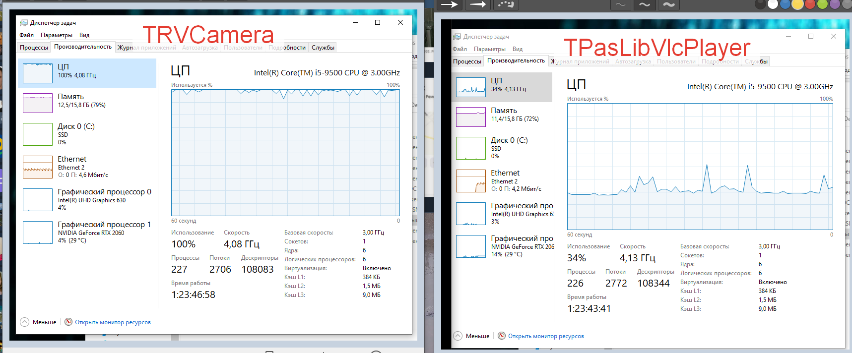

When using the component, the following situation arose: when starting the rtsp video stream, the computer processor load increases to 100%, and, as a result, the video stream slows down, and recording, respectively, also slows down, even when starting one camera. The picture shows the task managers when the TRVCamera and TPasLibVlcPlayer components are working: TRVCamera - loads the computer processor, TPasLibVlcPlayer uses a graphics processor, the video does not slow down. Somehow it is possible to solve this issue, to make the TRVCamera component use a GPU?

- TRVCamera vs VLC.png (170.49 KiB) Viewed 76267 times
