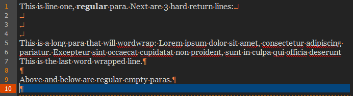

I've been working on this for a long time and just can't seem to get it to work beyond a very simple setup. What I want is to be able to figure out the type of lines in my paragraphs. I'm using that to determine what I display in my line numbers gutter. I'll put an image in to illustrate:

How can I determine if the caret is in a line that ends with a hard return (lines 2 - 4 above), is word wrapped (lines 5 - 7), is empty (lines 8 and 10), or a line that is the last line in a word wrapped para (line 7)?
Note that I loop through visible drawitems, not regular items when I parse the text. This needs to work even if there is formatted text and/or images within the text. Those 2 things have given me a lot of trouble. I can sometimes get code to work but as soon as I select a formatted word or image, it stops working.
