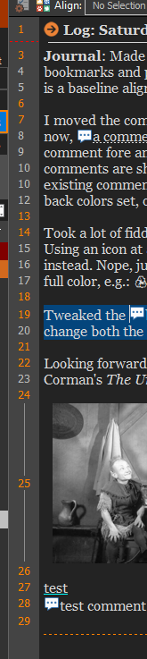

From what I can see, getting the line number works in a similar way, yes? Calculated, not stored? So, if my code is this:
      if NumberWrapLines1.Checked then
        LineNumber := memo.GetLineNo(DItem.ItemNo,DItem.Offs)
      else
        LineNumber := GetItemParaIndex(memo.RVData,DItem.ItemNo);
The time it takes to do either one should be about the same?

I'm using them for my rve line numbers. My test 100kb files with 3k to 4k lines work fine, even when scrolling which is when they get called a lot. It's all used in paint calls so everything seems fast enough. It's very unlikely I'll be using files anywhere that big normally but I like to test with them.
So far the hardest thing (for me) was to figure out how to number the wrapped lines. I have to use draw items for that and I'm still trying to figure those out. But it's all working pretty well at this point.
