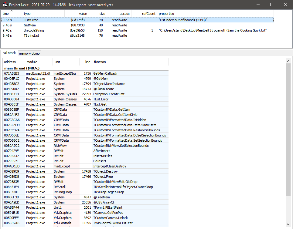

If I try to clear the existing data in my rve in the dropfile method, I get errors reported by madexcept. Mostly it's a list index out of bounds I think from the tcustomrvdata.getitem call. Not sure what the problem is. All I have in dropfile now is
RichViewEdit1.Clear;
exit;
If I load a large file, it loads OK. But if I try to load a smaller file, it throws the error. It still loads and appears to work, but the errors are concerning.
If I load a smaller file, then a larger one it's OK. But as soon as I try to drop a smaller file onto a larger one it errors IF I scroll the larger file down a ways first. If I leave the larger file scrolled all the way up it will let me drop the smaller file.

Can you give me the step-by-step instructions to reproduce this problem?

Sure...
Start new vcl project.
Add a trichviewedit.
Put "RichViewEdit1.Clear;" into DropFile method:
Run app.
Drop a large text file into rve (I use a large PAS source file).
It should load and come up scrolled to the bottom of the file, with text selected. Leave the scroll where it is, and click in the rve to deselect text.
Drop a smaller text file into rve. Should see the list out of bounds error now.
Does not seem to be related to the insert function as such, but the Clear or ClearAll calls. All I know is I have not been able to fix it.

The component does not expect that you clear content in this event. It expects that you insert something at the caret position.
The exception occurs when the component tries to select the inserted content.
