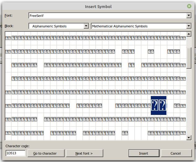

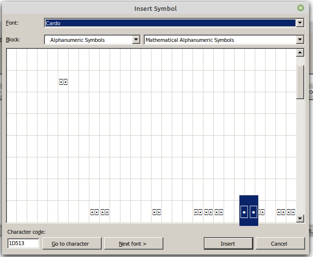

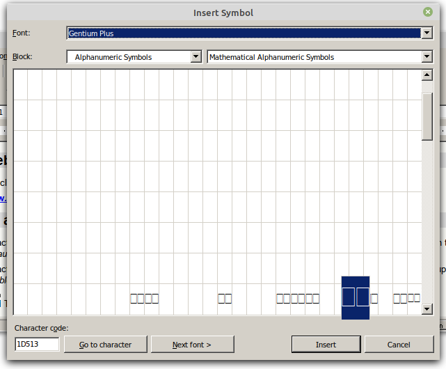

Thanks for the ideas Sergey.
This is what we are seeing you should be able to see the font names in the images.

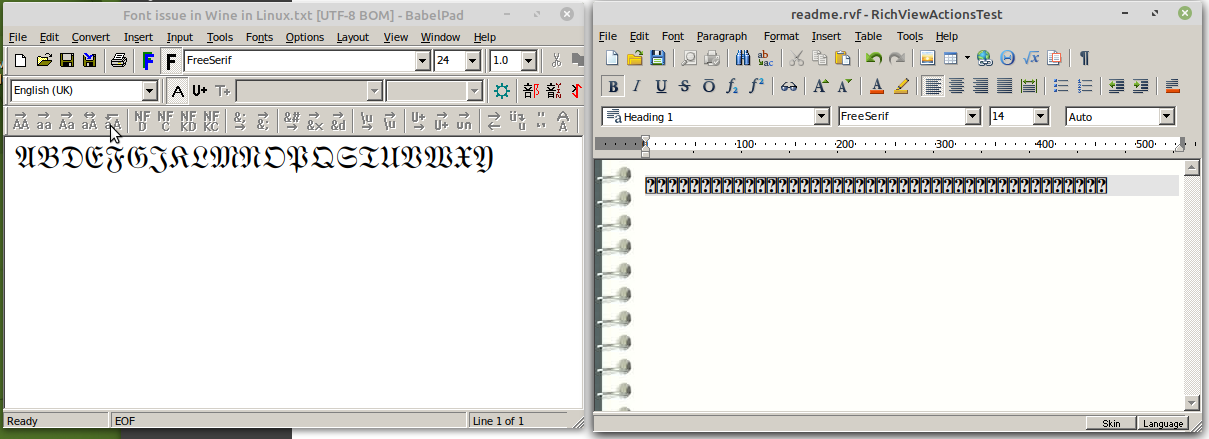

See at the very end for a comparison side by side with another application in Linux/Wine.
Here is something similar but comparing another program. Both TRichView and the other program are running in Linux/Wine.

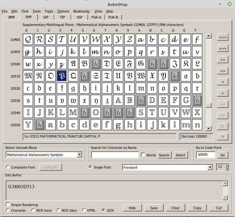

Also just to show that BabelMap works ok in Wine, here is a shot showing the problem character/s
