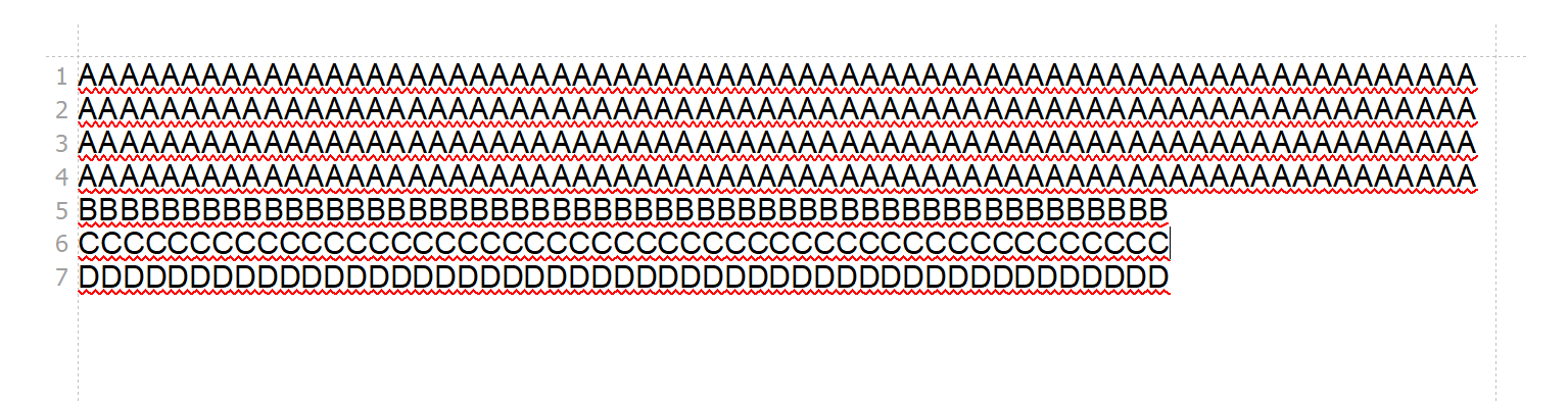

this is exactly what happens, if I order printing to start on line 4, it prints only the excerpt "DDDDDDDDDDDDDDDDDDDDDDDDDDDDDDDDDDDDDDDDDDDDDDDDDD"
because it believes that "AAAAAAAAAAAAAAAAAAAAAAAAAAAAAAAAAAAAAAAAAAAAAAAAAAAAAAAAAAAAAAAAAAAAAAAAAAAAAAAAAAAAAAAAAAAAAAAAAAAAAAAAAAAAAAAAAAAAAAAAAAAAAAAAAAAAAAAAAAAAAAAAAAAAAAAAAAAAAAAAAAAAAAAAAAAAAAAAAAAAAAAAAAAAAAAAAAAAAAAAAAAAAAAAAAAAAAAAAAAAAAAAAAAAAAAAAAAAAAAAAAAAAAAAAAAAAAAAAAAAAAAAAAAAAAAA"
is a single line because it was not generated by ENTER. I really need the component to behave according to the lines displayed to the user, it should be like this because it even induces the user to error when choosing the line number

the user just types the text, the component automatically breaks as it has to be, this is correct as in word. However when printing it needs that regardless of having Enter or not that it starts on the line that it only needs this, if MinPrintedItemNo doesn't work, could you indicate another way to get around this situation?

This feature is not supported yet.
It's not to difficult to implement a way to define a printing range with a higher precision than a range of items, to allow defining printed lines.
However, it was not implemented, mostly because this feature is rarely used.
I can implement it in future updates, but not right now, because currently I finish the next major update preparation, and it is feature-locked.
