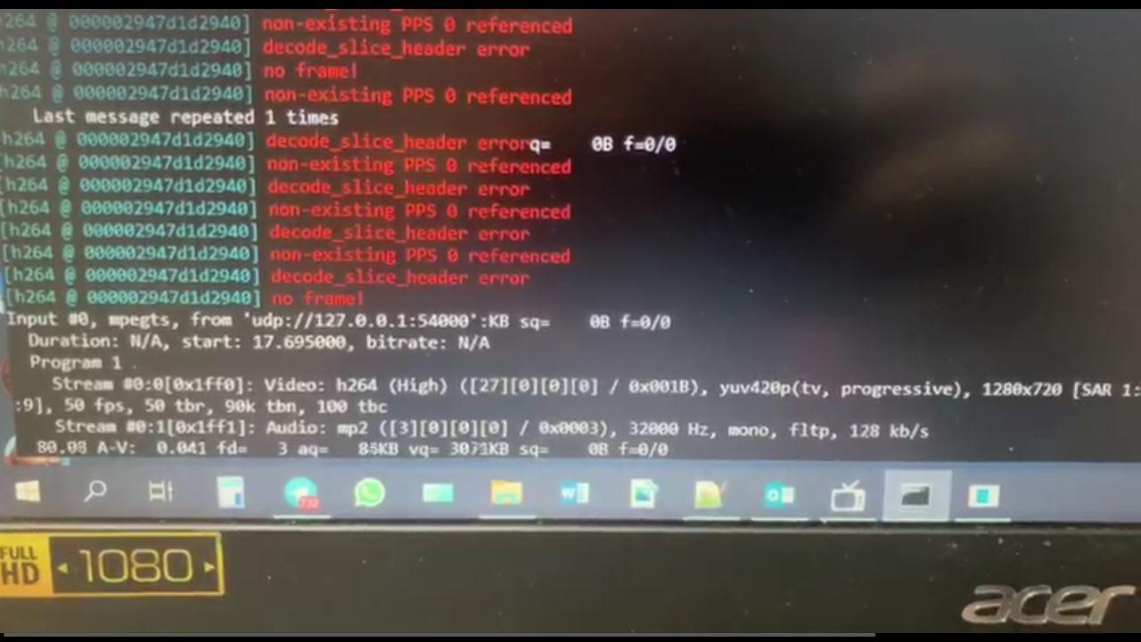

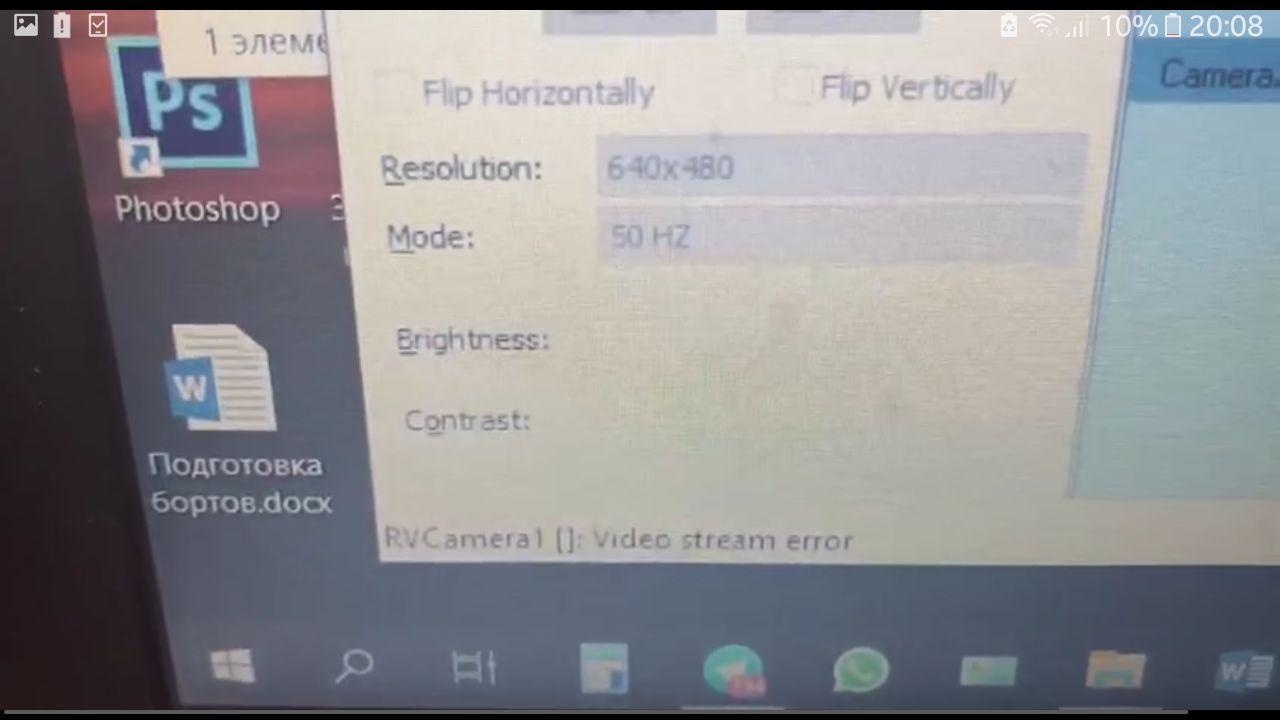

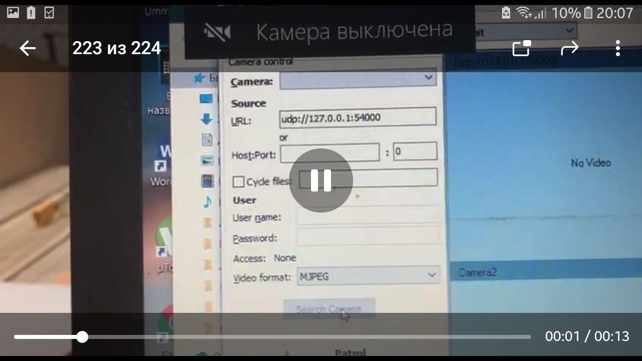

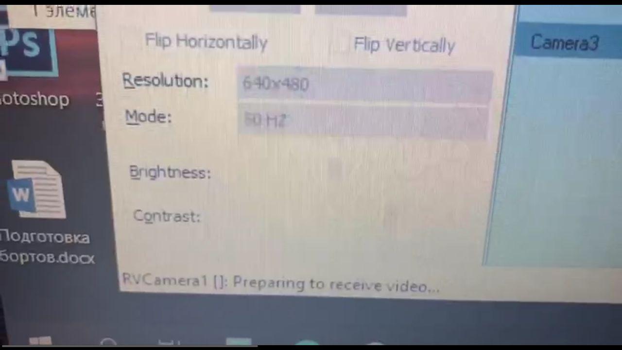

I have an h264 video stream that I want to display using RVCamera.
FFplay shows it:
But if I try to open the stream via MediaTest demo application it says at first "preparing to revieve" and then "video stream error"
Could you guess what is the reason and what is the error?
FFplay shows it:

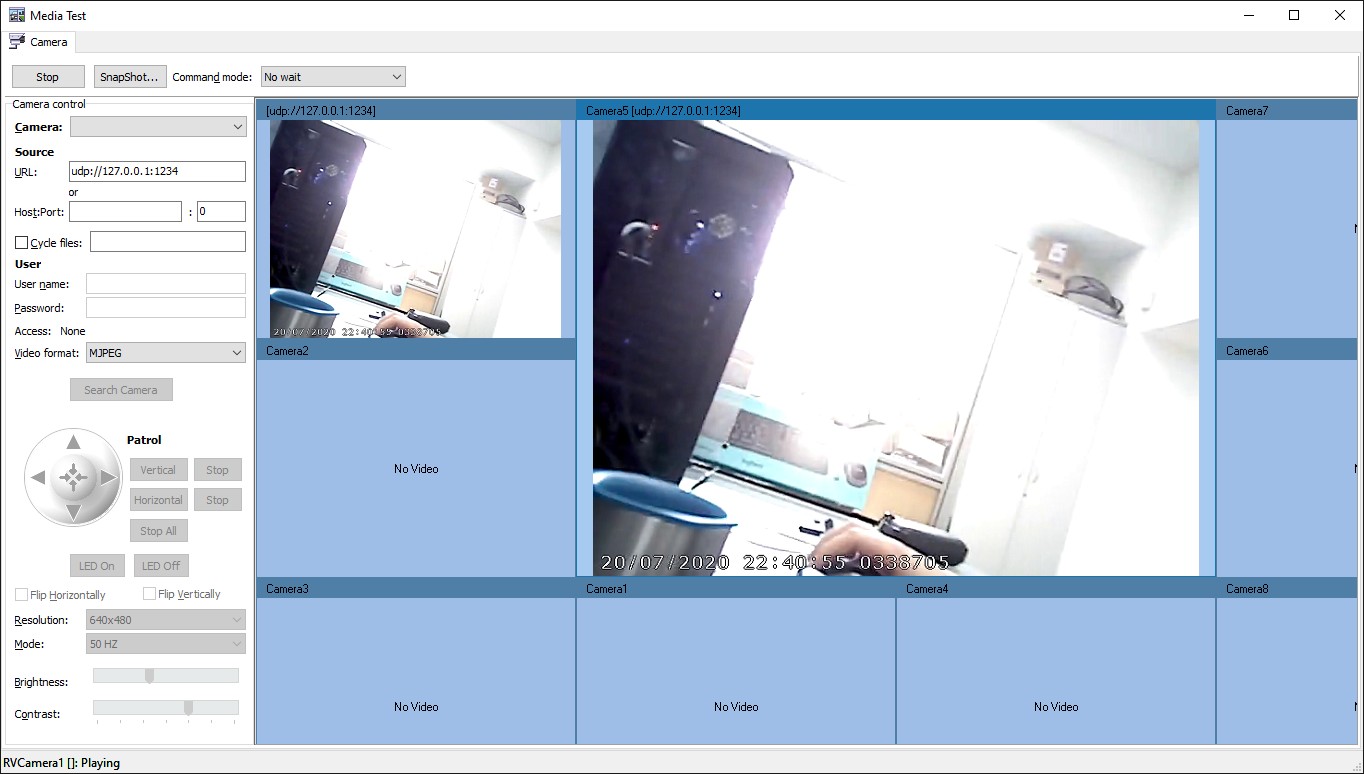

Re: Video stream error on trying to open udp://127.0.0.1:54000
I get the same error if I try to stream the file (https://yadi.sk/i/6Gr0hRuHFAlhJw) via vlc
:sout=#udp{dst=127.0.0.1:1234} :no-sout-all :sout-keep
ffplay.exe -i udp://127.0.0.1:1234 shows video
mediatest gets video stream error
Could you please check it and find a solution?
Tried to set RVCamera.FFMpegProperty.UseFFmpegProperty = False to all cameras in MediaTest application, but the result is the same (video stream error).
Did you use this demo project for test or some other?
- Posts: 17839
I used another demo, but MediaTest is ok.
Two things:
1) FFmpeg DLLs must be available for MediaTest (you can copy them to the MediaTest folder)
2) It must not be FFmpeg 4.3.1 (or some versions close to it). It crashes. The newest daily build of FFmpeg is OK, and v4.2.1 and older is ok.
Two things:
Thanks!
Finally I've got video.
Can I set timeout to 0 instead of assigning RVCamera.FFMpegProperty.UseFFmpegProperty = False?

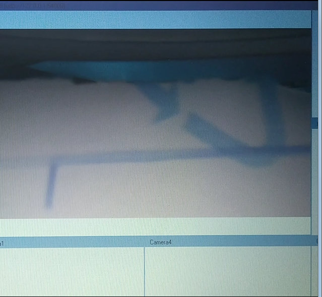

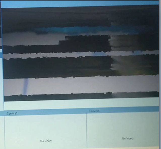

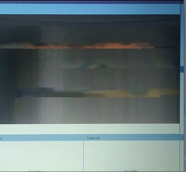

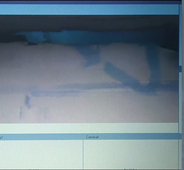

So, since version 7.5 I get video, but in a minute it's getting corrupted.
First 30 seconds image: And then this: And this: And this:
What is the reason of this corruption?
FFMpegProperties are set by default except for Audio=false.

1)
Can video frame corruption be reproduced reliably?
Do you have the same results with ffplay?
Probably, the reason is in UDP protocol. It does not guarantee that data are delivered correctly.
Yes.
No. FFPlay shows without corruption.
If the sender was on a remote PC - yes. But it is on the same PC (localhost IP address is used) and there should be no problems with UDP.Sergey Tkachenko wrote: Fri Aug 14, 2020 2:22 pm Probably, the reason is in UDP protocol. It does not guarantee that data are delivered correctly.
