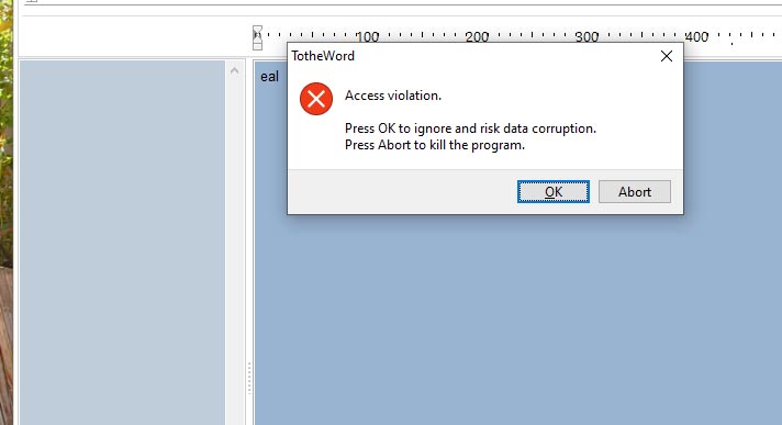

Re: Oddest error on L or l key stroke OR ALT + L or l
Regular error non-debug
- L-bug.jpg (41.46 KiB) Viewed 39422 times

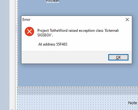

Error in debugger error
And here is from the Assembler window:
0055F45A 7426 je 0x55f482 <COMCTRLS$_$TTOOLBUTTON_$__$$_DIALOGCHAR$TLMKEY$$BOOLEAN+114>
0055F45C 8b45f8 mov -0x8(%ebp),%eax
0055F45F 8b80d4020000 mov 0x2d4(%eax),%eax
0055F465 80b8f003000000 cmpb $0x0,0x3f0(%eax)
The error happens on the last part.
However, I just tried it on a new TRichViewEdit with a new RVStyle and the error still happens so maybe it is panel or form related.
- L-bug-debugger.jpg (40.11 KiB) Viewed 39422 times
