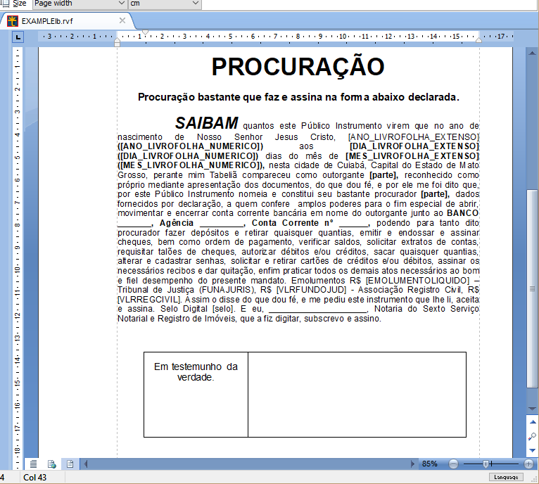

I'm attaching an image for better understanding, notice that in the red square I push the word with spaces but the red line does not automatically adjust to the end as it should
http://prntscr.com/k15tsa

I took an example to show you, but none of my rtf texts corrects the line spacing when the text is justified and then successive line spacing is made.
tiagosis
Posts: 64
Joined: Thu Apr 13, 2017 5:34 pm
Re: justify - paragraph
Post by tiagosis »
I took an example to show you, but none of my rtf texts corrects the line spacing when the text is justified and then added spaces in the line. what I need is that added spaces to the line if self tuning is justified just like in word.
This is what I see when I load this document in ScaleRichView:
The large paragraph started from "SAIBAM" is justified, text is aligned to the both sides of lines (except for the last paragraph line).
I do not understand what you want to change.

in the "Capital do Estado de Mato..." section if you push this excerpt with spaces so that it falls on the line below. Notice that the line above to which this part belonged was not justified.
Ok, now I understand. Sorry, justifying multiple spaces are still not implemented. Only one space character must be between words.
I can still repeat my original suggestion: do not use multiple spaces to move text to the new line. Instead, press Shift+Enter to add a line break (and assign RichViewJustifyBeforeLineBreak = True)
