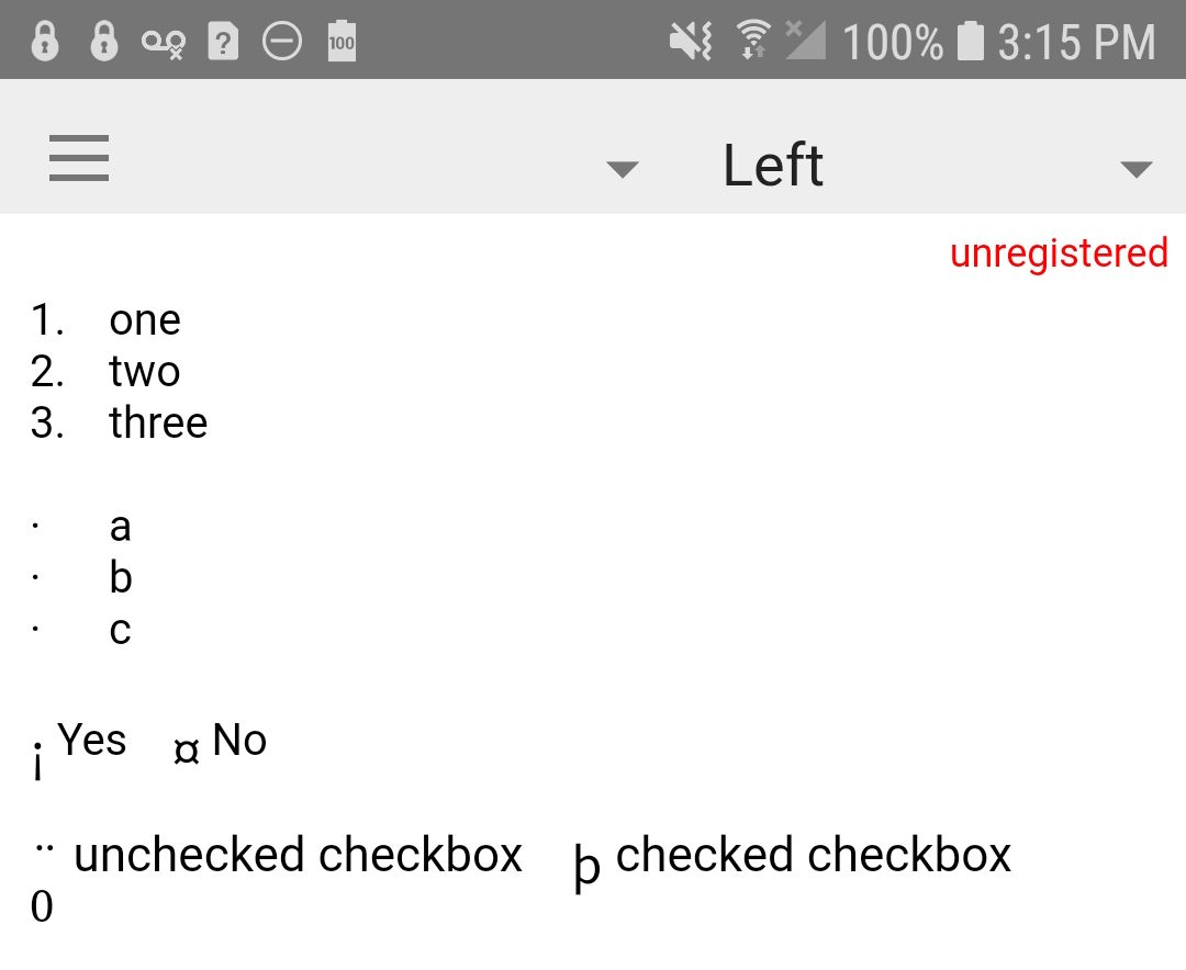

When RTFReadProperties.ConvertSymbolFonts is False, bullets, checkboxes, radio buttons show up fine on Windows. On Android, bullets show up fine, though tiny, but not checkboxes and radio buttons. See "SymbolSet Windows.jpg" and "SymbolSet Android.jpg".

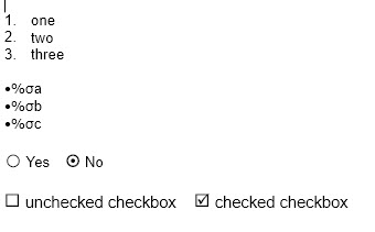

When RTFReadProperties.ConvertSymbolFonts is True, checkboxes, radio buttons show up fine on Windows, but not bullets (double char kind of thing). On Android, bullets come out like they do on Windows (double char thing). Checkboxes and radio buttons are better but not good. Unchecked radio button looks good, but not the checked version. For checkboxes, checked and unchecked are both checked. See "SymbolSet Win Convert.jpg" and "SymbolSet Android Convert.jpg".

My main concern is the bullets when ConvertSymbolFonts is True for Android and iOS (my app is only for mobile). For checkboxes and radio buttons I'm thinking/hoping maybe I can find alternative chars that convert better if I can't get my current Wingding chars to work.

I now have the registered version, and I noticed an odd thing in the header for bullets that has a %s in it, which seems a bit off. Example (typed from a screen shot, so there may be typos):
Is this expected? Seems like an unresolved Format tag.
