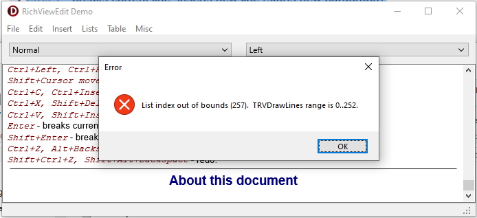

When using RAD Studio 12.3 and TRichView FMX version 22.4, I'm getting an out-of-bounds error when deleting content from a TRichViewEdit. This error doesn't appear when using RAD 12.2.

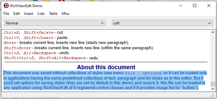

Using the RVEditDemo example in the FMX suite, I highlight the bottom content as indicated.
With content highlighted, pressing Delete causes the information to be removed (expected) and the appearance of an out-of-bounds message (unexpected).

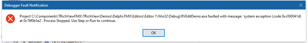

Pressing the OK clears the box, then it reappears. Pressing OK the second time brings a Debugger Fault Notification (when debugging) else abort.
