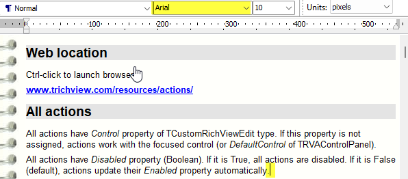

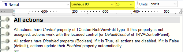

While working with Richviewedits I found some dissonances regarding fonts.

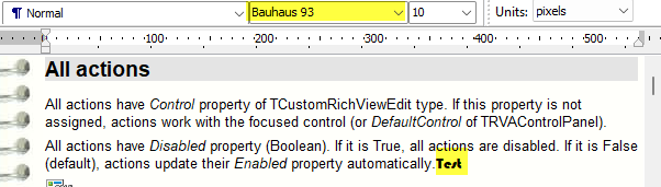

If I change the font at the end of a sentence and start typing immediately, everything is fine, and I can start writing with the selected font.
Nevertheless, if I click at the current cursor position, the font resets.
In other applications like MS Word, it does not reset.
Is there anything I can do to have the same behavior as in MS Word?

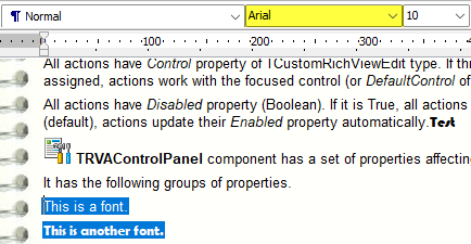

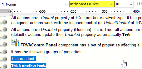

While testing, I found another dissonance regarding fonts from selected paragraphs.
Situation:
I have a paragraph that contains two or more different fonts. I select the complete section. Now the combo box for the font is filled with the last font.
Selection starts from the top.
Selection starts from the bottom.
The font combo box is empty if I have the same situation in MS Word.
Is there anything I can do to get the same behavior as in MS Word?
