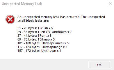

I use RVMedia to make a stream and capture the image with GetCurrentImage and put it in a TIMAGE.
When performing the process, the system increases the memory. Using ReportMemoryLeaksOnShutdown := True;, returns the attached image.
If I don't use the process, no error happens.
Memory High on RVMedia

- ErroRVMedia.png (11.33 KiB) Viewed 26354 times

You should use one of two methods to get the image:
1. RVCamera.GetSnapShot. In this case, you must free the returned object yourself.
2. In RVCamera.OnGetImage, use Img parameter. Do not free Img, but do not use it outside this event (copy to your image)

Good Morning
Solved problem.
Grateful
var ImageWrapper: TRVImageWrapper;
try
ImageWrapper := RVCamera.GetSnapShot;
Image.Picture.Graphic := ImageWrapper.Bitmap.GetBitmap;
ImageWrapper.Free;
