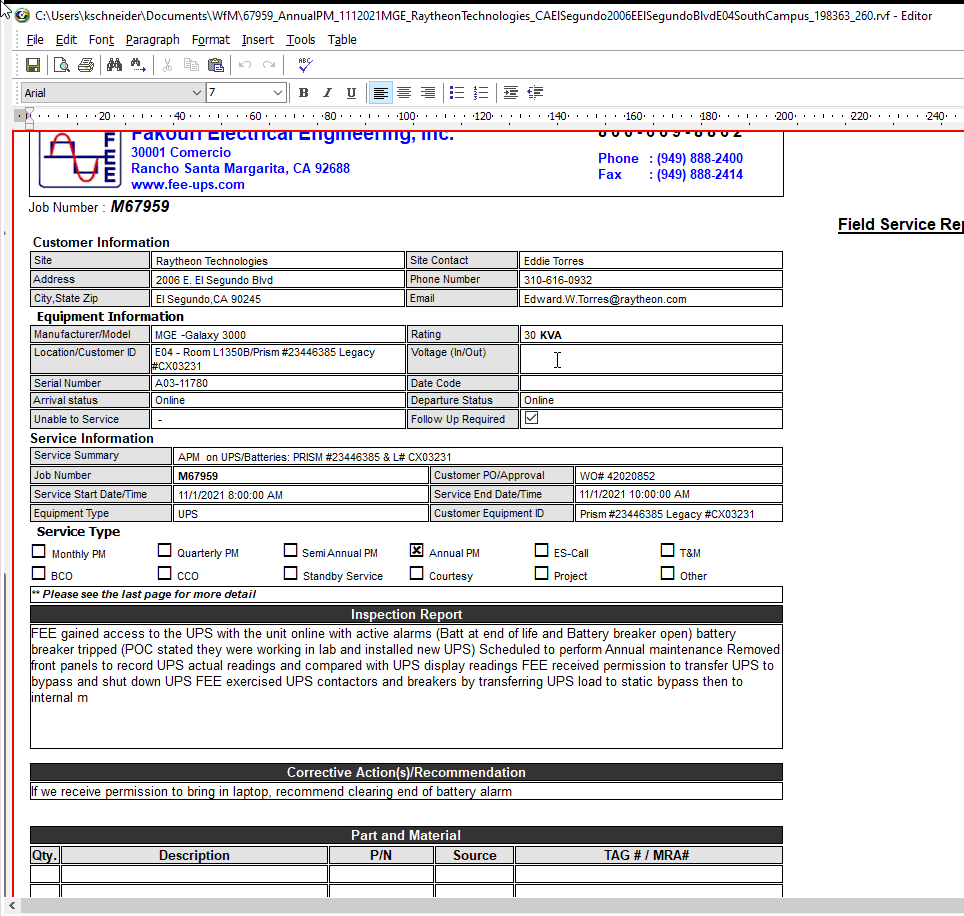

after upgrading from 19 to 20 my RVF editor gets an access violation when I click anywhere in the toolbar or doc. My editor was derived from ActionTest years ago. It doesn't happen in all merged docs but does every time when the attached F027_MergedDoc.rvf is opened. This doc was created via a data merge with the attached F027SALESORDER.rvf.

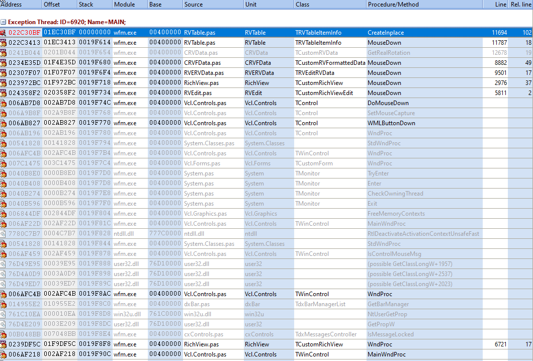

Here's where the violation takes place:
022C30BF 01EC30BF 00000000 wfm.exe 00400000 RVTable.pas RVTable TRVTableItemInfo CreateInplace 11694 102

I've attached the RVF before and after the merge, hoping you can spot something.
I've also attached a snippet of the call stack.

- FEE_JobM67959.png (77 KiB) Viewed 8133 times
- FEE_BugEditingMergedDoc.png (99.65 KiB) Viewed 8133 times
- Callstack.png (127.76 KiB) Viewed 8133 times
