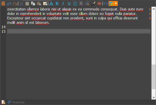

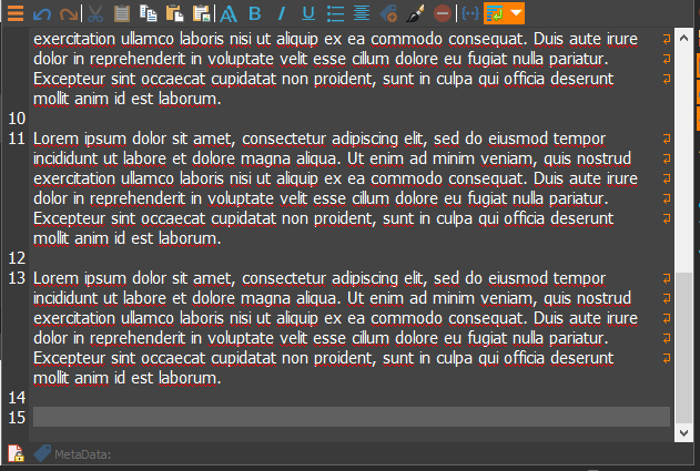

In my scintilla control, I can set it to scroll to the end of the text:
Or, scroll past the end:
I'd like to get the rve to scroll past the end if possible.

I was actually wanting to scroll past the end of the doc, beyond the last line of actual text. But I doubt the rve does that. Not a big deal, be nice if it did but no problem.
