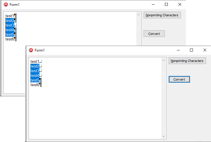

Could you please provide a fix for "Paragraph breaks -> line breaks" which converts the line before the first selected text?
See attached screenshot, when you select from test2 to test5, it will also convert the paragraph break before test2 when it shouldn't.
See attached sample project to quickly reproduce this problem.
Thank you.

Posts: 17877
Re: [Example] DeleteBlankLines, RemoveParagraphBreaks, etc.
procedure MakeSoftLineBreaksEd(rve: TCustomRichViewEdit);
var ItemNo1, Offs1, ItemNo2, Offs2: Integer;
    Whole, FR: Boolean;
  i: Integer;
  rve := rve.TopLevelEditor;
  if not rve.BeforeChange(False) then
    exit;
  rve.GetSelectionBounds(ItemNo1, Offs1, ItemNo2, Offs2, True);
  Whole := (ItemNo1<0) or ((ItemNo1=ItemNo2) and (Offs1=Offs2));
  if Whole then
    ItemNo1 := 0;
    ItemNo2 := rve.ItemCount-1;
  end
  // ADDED
  else
   inc(ItemNo1);
  // END ADDED
  rve.BeginUndoGroup(rvutPara);
  rve.SetUndoGroupMode(True);
  if ItemNo1<1 then
    ItemNo1 := 1;
  for i := ItemNo2 downto ItemNo1 do
    if rve.IsParaStart(i) and (rve.GetItemStyle(i)<>rvsListMarker) and
      not rve.GetItem(i-1).GetBoolValue(rvbpFullWidth) then
       TRVEditRVData(rve.RVData).Do_BR(i, True, FR);
  rve.SetUndoGroupMode(False);
  rve.Change;
  rve.Reformat;
jonjon
Posts: 482
Joined: Sat Aug 27, 2005 4:19 pm
Post by jonjon »
Thank you Sergey but it looks like this fix is incomplete: if only part of the first line is selected (e.g. instead of selecting "test2" you only select "st2") then the line before that one is converted when it shouldn't.
Posts: 17877
I modified the code in my previous reply to fix it.
jonjon
Posts: 482
Post by jonjon »
Great. Thanks.
