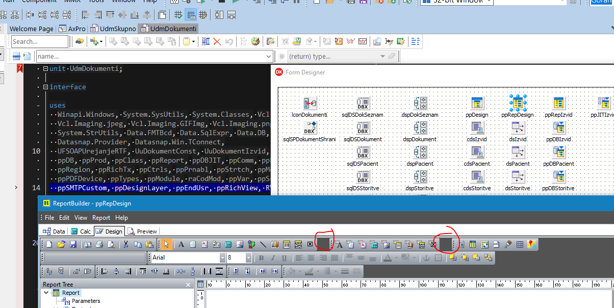

I have updated the ReportBuilder from version 19.03 to 22.02 yesterday and after that I reruned the installation for TRichView and I don't see the components for TppRichView and TppDBRichView in the ReportDesigner anymore. To be sure I just reruned the installation and I see in the listbox:
"Installing optional integration in ReportBuilder... Skipped."
What can I do to bring back the components to RB designer? I use RB 20.02, TRichView 19.03 and the TScaleRichView 9.0.3

I have a weird situation. The icons in ReportBuilder designer have dissapeared in our big application, just like that, nothing special was done. I sadi okay, let's update TRichView with new version 18.4 and then also TScaleRichView with the latest 9.2 (as per installer) and again, no icons in TppReport. Then I created a new blank project, added ppRichView in the Uses section as in our big application, added TppReport and opened the designer. On my surprise, the icons were there! I saved the project closed all, even Delphi Berlin and restarted our big application and again, no icons. I've tried a few variations of closing/restarting but in big application I can't get icons in the toolbars, in new, empty no problem. Even if I rebuild and start the application and open a hidden designer for reports, I see icons but not in the design time. If I try to open the report with RichView in design time, Delphi complaints. Any ideas?
I use Delphi Berlin Update 2, RB 20.02, DevExpress 18.2.11 etc on Windows 10 Enterprise 2004, build 19041.329. Btw, the RichView 18.4 installer didn't sense the DevExpress, which we have full subscription pack (all features).

Sorry to be a bit late, I had really busy days in past week. ppRichView is everywhere needed in software, on all datamodules where it TppReport. No problem in opening the reports in RUNTIME (using TppDesigner), problem is in DESIGN TIME. In design time I do not have the icons. In "easy" project I have but not in a complex software we are making.

Probably, for some reasons, RV+RB package is unloaded when this project is open.
Try opening this project, then go to menu "Components | Install Packages", find the package named "TRichView wrapper for ReportBuilder for Delphi 10.1 Berlin". If it is unchecked, check it.

now I am ebarrassed, this solved the problem. Thank You very much!
