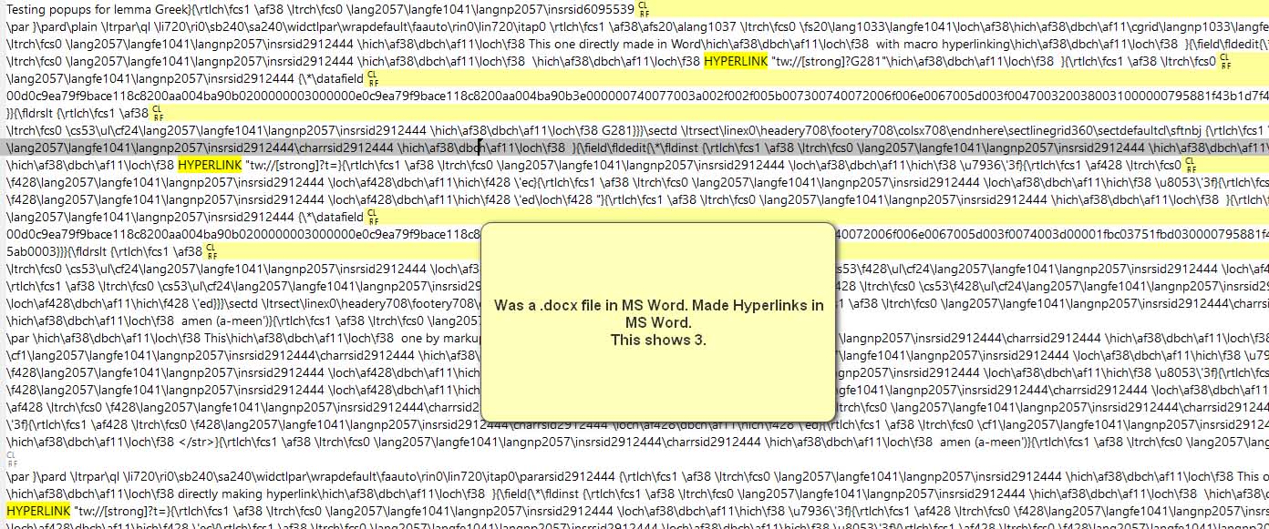

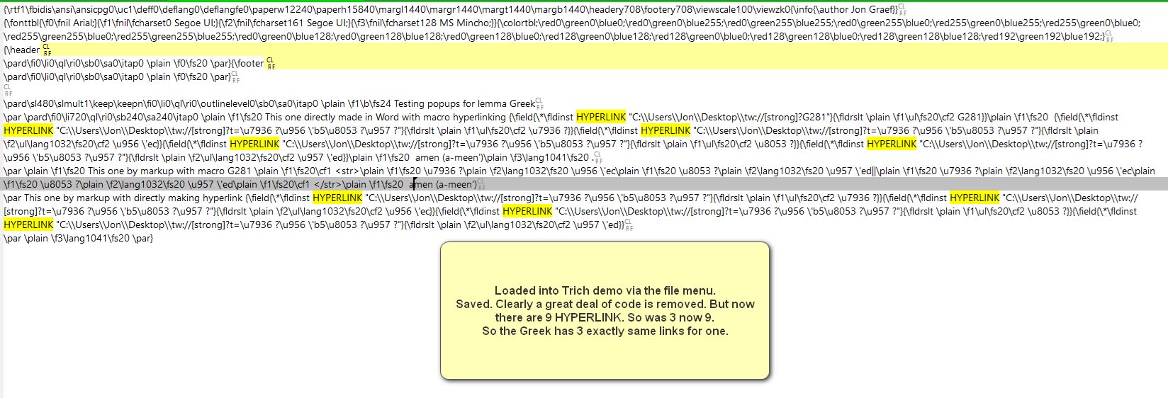

You need to compare the files in a text editor to see the code. Is it normal to make 3 HYPERLINK the same for each Greek word, and the G281 only has one HYPERLINK
(Edit fixed image)
After saving

In this document, some characters are loaded as separate hyperlinks. I'll try to optimize it.
Re: Possible hyperlink bug
As I said before, in this RTF, Unicode hyperlink is loaded in TRichView as several hypertext items. In TRichView, several hypertext items that have the same target are handled like a single hyperlink. When exporting to DocX, these items are saved as a single hyperlink as well. But when exporting to RTF, each item is saved as a separate hyperlink.
I re-checked this RTF. The link is loaded as several items because different characters in it have different Charsets.
TRichView has an option to ignore Charsets from RTF: assign RichView.RTFReadProperties.UseCharsetForUnicode = True. In this mode, RichView.RTFReadProperties.CharsetForUnicode will be applied to all text loaded from RTF, and this hyperlink will be loaded as a single item.
I modified RTF saving code. In the next update, adjacent hypertext items having the same target will be exported to RTF as a single hyperlink.
