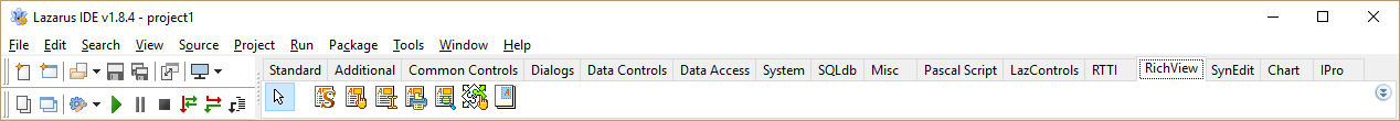

Yesterday I finally managed to compile TRichView in Lazarus, almost without hints and warnings.
I still need to complete printing support and to test everything.

Current progress:
- normal and DB TRichView components are installed;
- all tutorial demos are ported to Lazarus, are tested and work correctly
- all designtime property and component editors are ported.
I'll continue porting and testing all demo projects.
The first update will be released when I convert TRichView, RvHtmlImporter, RichViewXML, HunSpell and ASpell spell checkers.
Then I'll proceed to port RichViewActions, ScaleRichView and Report Workshop.

Current progress: I've converted all TRichView demo projects to Lazarus. DB-demos were converted to use TDbf component. Everything works perfectly.
Things to do before the first release: convert Demos\Addins, RichViewXML, RvHtmlImporter, HunSpell and ASpell.

We are porting RichViewActions to Lazarus.
Current progress:
Everything can be compiled, ActionTest demo can be run.
All additional components included in RichViewActions (grids, color pickers, spin edits, font and style comboboxes) are ported.
Toolbar images look bad, datamodules need to be recreated for Lazarus.
Some dialogs work correctly, some dialogs have glitches or do not work at all.
There is still a lot of work to be done.
