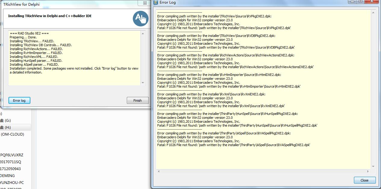

I tried to install the TRichView.v.17.03.0 on XE2.
so i use the IDEInstall.exe in the folder Setup and choose the file TRichViewFullDelphi.iide to instll it.
But it failed.
And I got a error message like this:
error mes
error mes
So what can i do next?

I modified the Files section to "Files=%TRichViewVCL" in the file of TRichViewFullDelphi.iide.
But when i tried to install the trichview again, i got a new wrong message:

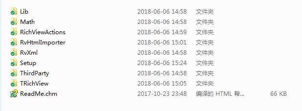

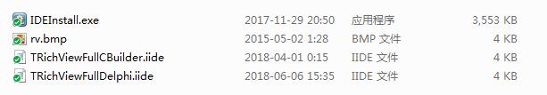

I check out my folders, but no file named installer found.
i got these files like this:
And only IDEInstall.exe in the folder Setup
Re: Install issue via XE2
Where did you get these files from? Normally, they are unpacked by the installer, named TRichViewSetup-17.exe or like this.
