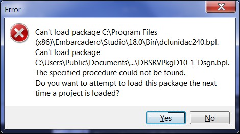

What's the next error message? The most probably, it shows that some package cannot be loaded, and the actual error is not in RVPkgD10_1, but in that package. That package requires RVPkgD10_1, and when RVPkgD10_1 was modified and recompiled, that package must be recompiled as well.

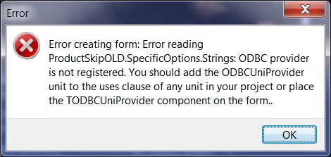

The next 2 are attached.
Note that when I uninstalled and then reinstalled, the messages were slightly different.
But they still referenced one of the UniDac files and one of the RichView files.
The second error, InstallError2.jpg was caused because the components on one of the Tabs, was not there so
when Delphi tried to load that form it could not.
I can't see how the Unidac ( Devart Component for database access ) would even know about RichView.
Please also note I also reinstalled the UniDac components after Richview did not work.

Re: 16.5.1 Crashes Delphi 10.1
I believe the problem with UniDAC (dclunidac240.bpl and error about ODBC provider) is not related to our components.
The second error message refers to ScaleRichView package.
After updating TRichView, you need to update and recompile ScaleRichView as well, and this error must disappear.
