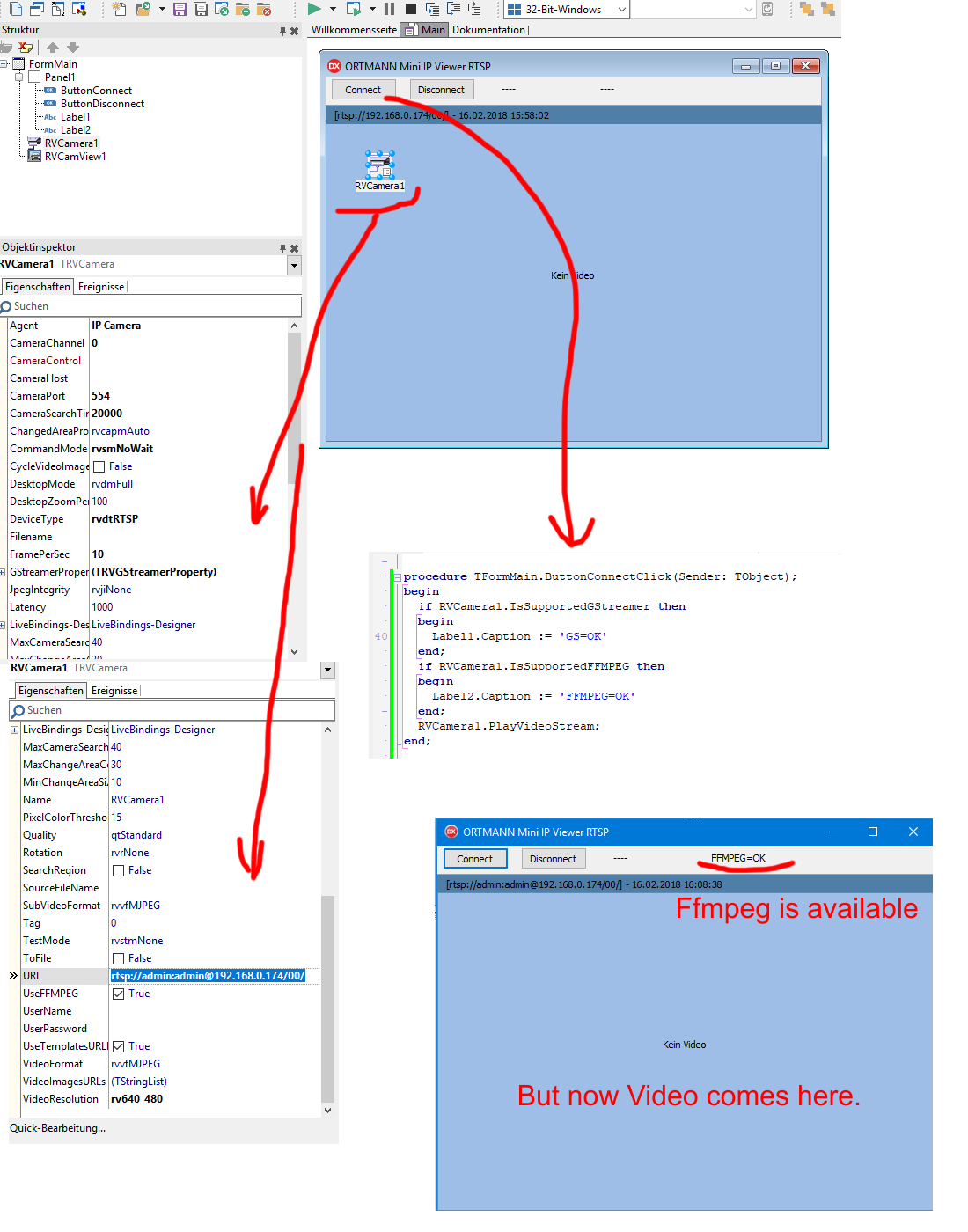

Hello, please I need support.
I am using RVMedia 5.0.2 under Delphi Tokyo 10.2.2
I have a IP camera in the local network, which streams mjpeg in RTSP.
The IP address and necesary link in the LAN network is known.
Example:
rtsp://admin:[email protected]/00/

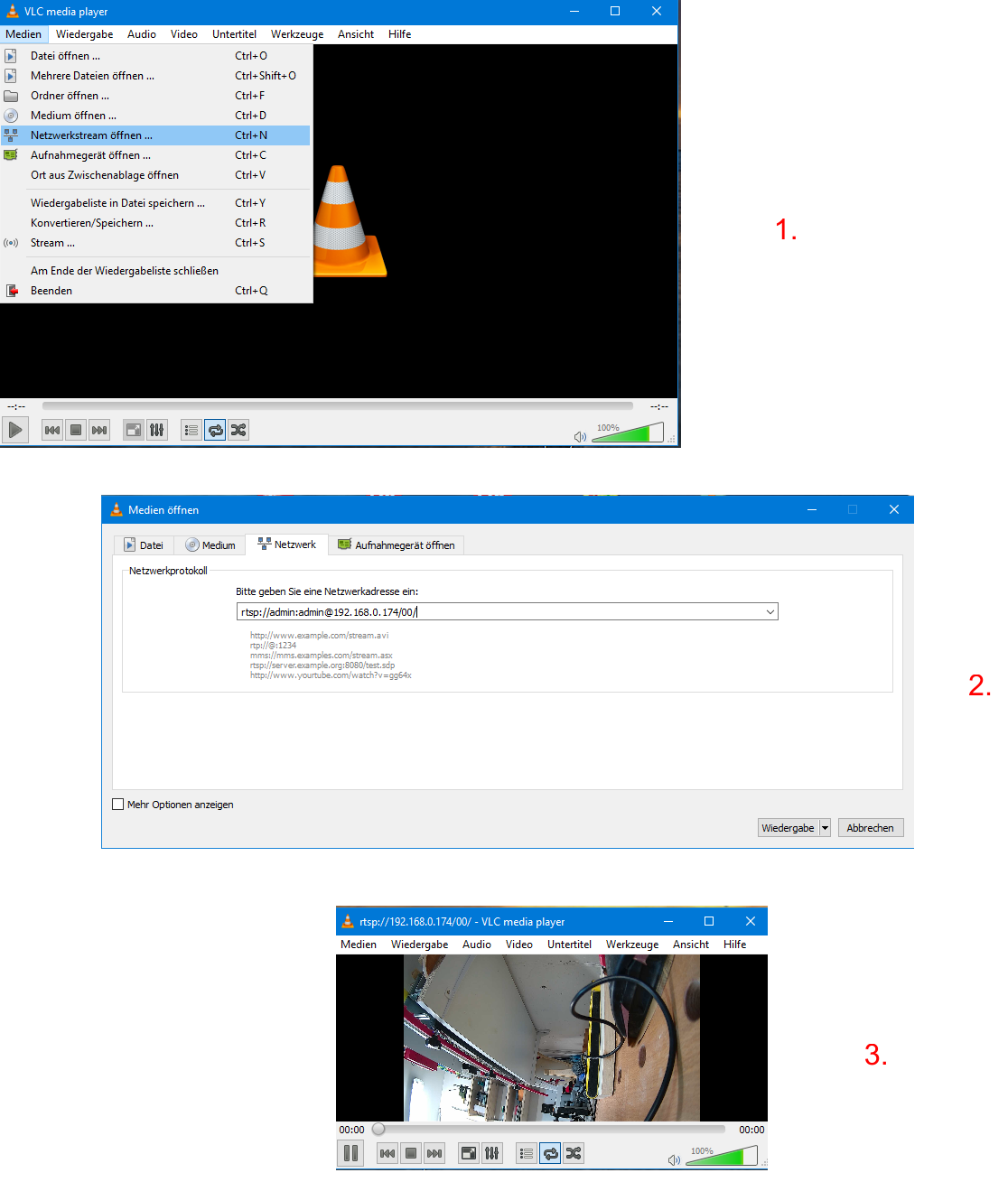

For testing, I can enter this address in any simple common player
like VCL media player, and it immediately streams and shows the video.
However, in RVMedia I can not get it to work. Seams I am doing something wrong.
I tried a lot, but can not find the correct setting to get it work.
Of course the latest available FFmpeg dlls, I placed into the exe folder.
And the RVCamera1.IsSupportedFFMPEG returns true.
(I just removed them from the Zip, because the file was too large for this forum then).
Regarding the online help, with ffmpeg it should work
with RTSP and mjpeg.
The Cam is configured to stream mjpeg.
But I also tried everything, using .h264, but does not work too.
I setup a very simple project, only Cam and Viewer.
In the pictures, you see all my settings. But does not work.
What do I need to setup, to get it work?
Please help, thank you.

Re: IP Cam with RTSP, can not get video working
RVMedia 5.0.2 does not support the latest version of FFMpeg. Try RVMedia 5.3 beta
Hello thank you,
but, I meant which is the ffmpeg version for the 5.0.2 which I bought?
(the 5.3 complains, that it found an old serial number, and does not install, so I can not do beta testing).
- Posts: 17879
If you can make this camera available from internet (for example, using some free dynamic DNS service) and send a link to us, we can check what's wrong with it.
By the way, it VLC shows a stream, it is not necessary that this stream can be displayed using FFmpeg.
I guess, it first tries to open it with FFmpeg, and if it fails, it tries some other method. When it happens, if you open Tools | Media information dialog, you will see a double number of video and audio codecs. This situation rarely happens, but I saw it.

- Posts: 17879
Summary for readers of this forum:
This camera produced video that cannot be displayed by FFmpeg.
It could be displayed with GStreamer, but we have to make some corrections in our code to enable MJPEG via RTSP support.
In the next update, we plan to implement native MJPEG via RTSP support, without FFmpeg or GStreamer.
