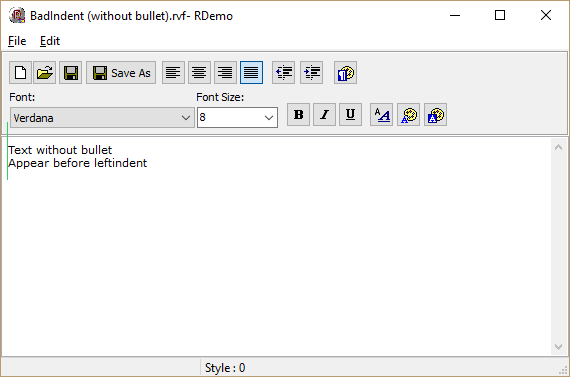

Re: PrintPreview with images and text
Sorry, I see nothing wrong with your "bad" file.
All indents are zeros,
This is how it looks after loading in "Editor 2" demo: LeftMarign = 5 pixels, I added a green line showing it.

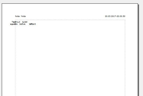

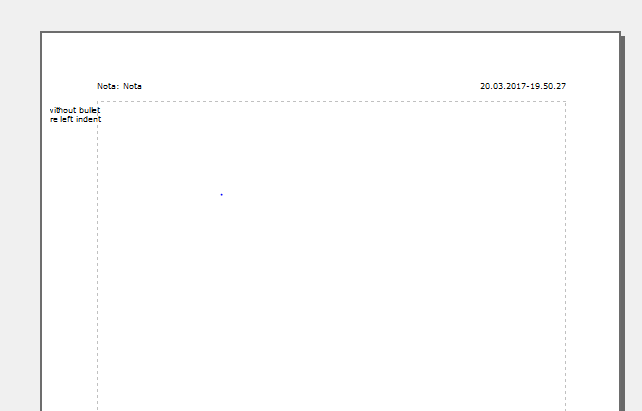

Hello
I see text correctly in my tdbrichviewedit (and in Editor2 demo), but
in PrintPreview text appears before left margin
I attach two files: ppl (printpreview with rvaleft alignment in tdbrichviewedit) and ppj (printpreview with rvajustify alignment in tdbrichviewedit)
Thanks in advance
Thanks in advance
- ppl.png (4.1 KiB) Viewed 38277 times
- ppj.png (4.24 KiB) Viewed 38277 times
Hello, I have found my error.
It is not in the tdbrichviewedit but in PrintPreview, specifically in onpageprepaint event, there is an align modification with settextalign that causes the problem.
I have corrected it by saving the alignment previously and restoring it later
Sorry and thanks.
Sorry and thanks.
